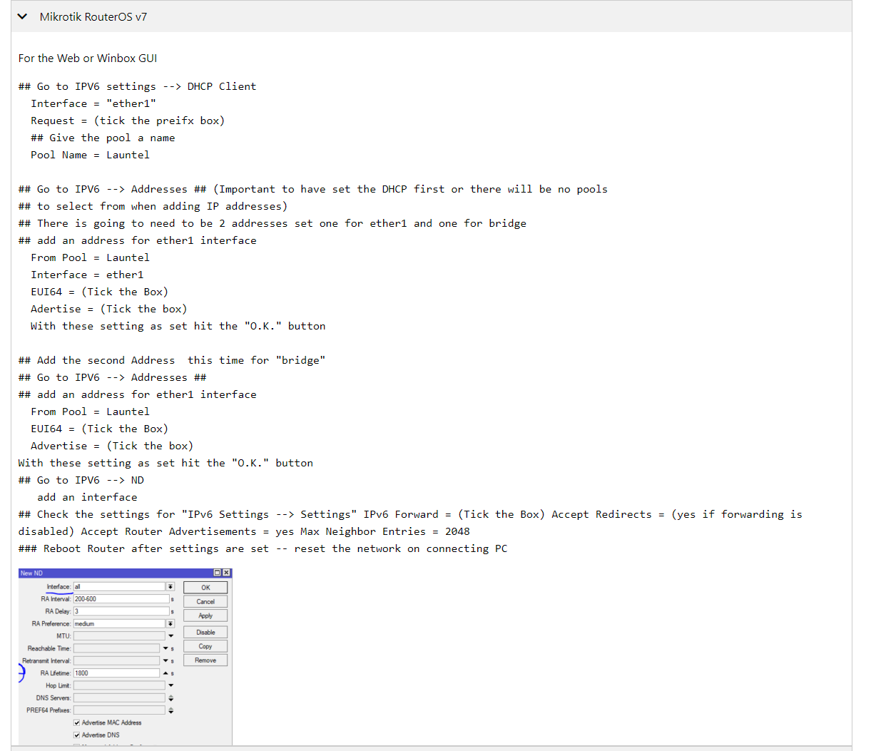

i have similiar setup but a tplink switch instead but all mine work??
wifi and lan so not sure whats happening here m8
i just followed my isp directions like this then rebooted
Are you telling me that your TPLink switch is getting a globally-routable IPv6 address from your gateway router, and that all of the wired-only clients behind it are, too?
That’s basically what my linked article says.
correct im saying all lan devices behind the tplink switch have a ipv6 address given but the switch itself doesn’t have one that i can see it is old as im awaiting on my new switch to turn up
so the switch looks as tho it is just passing the ipv6 info on from the hapax3
my wifi devices do but thats from my hapax3 router tho
so looks like your switch isnt playing nice

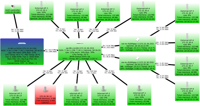

Here is my current home configuration

I don’t have CRS328 anywhere, but I have a place with CRS326. This switch does not have the IPv6 option enabled at all. And all clients that are connected via cable are successfully getting IPv6 addresses.
# 2024-10-16 10:37:07 by RouterOS 7.16.1
# software id =
# model = CCR1016-12G
# serial number =
/ipv6 dhcp-server option add code=23 name=dns value="'fe80::c6ad:34ff:fec3:5a8a''fe80::c6ad:34ff:fec3:5a8a'"
/ipv6 settings set accept-router-advertisements=yes max-neighbor-entries=2048
/ipv6 address add from-pool=ipv6-pool interface=bridge1
/ipv6 dhcp-client add add-default-route=yes interface=ether1 pool-name=ipv6-pool pool-prefix-length=66 rapid-commit=no request=prefix use-interface-duid=yes use-peer-dns=no
/ipv6 dhcp-server add address-pool=ipv6-pool dhcp-option=dns interface=bridge1 lease-time=1h name=server-bridge1 rapid-commit=no
/ipv6 nd set [ find default=yes ] advertise-dns=no disabled=yes
/ipv6 nd add advertise-dns=no dns=fe80::c6ad:34ff:fec3:5a8a,fe80::c6ad:34ff:fec3:5a8a hop-limit=64 interface=bridge1 other-configuration=yes ra-interval=10s-20s ra-lifetime=5m
/ipv6 nd prefix default set preferred-lifetime=30s valid-lifetime=1m
# software id =
# model = CRS326-24G-2S+
# serial number =
/ipv6 settings set disable-ipv6=yes max-neighbor-entries=2048
