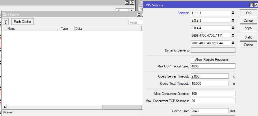

I have asking about DNS cache in IPv6.
I have using Ipv6 as DHCP for my office but DNS cache is not coming.

But DNS cache works, only there must be something trying to use it. Also, I missed that before, you need to have Allow Remote Requests enabled, but make sure (using firewall) that you allow only your networks to use it, not the whole world.
I have no idea on IPv6 firewall rules can you please share me on this.

In Reply #4 you show DNS settings but you have not enabled “Allow remote requests”.
This means your DNS server is only used by the router itself. Is that what you want?
When you want to use it from other computers, you need to enable “Allow remote requests” AND you need to make sure it is not accessible from internet!
(i.e. make sure your firewall does not pass incoming DNS requests)
The last filter rule effectively blocks all connections which don’t originate from LAN interfaces … so did you add LAN interfaces of your CCR to the mentioned interface list?
If yes, then check filter rules statistics to see which rule blocks the connectivity.
I need DNS cache in my CCR but it was not working on IPv6.
