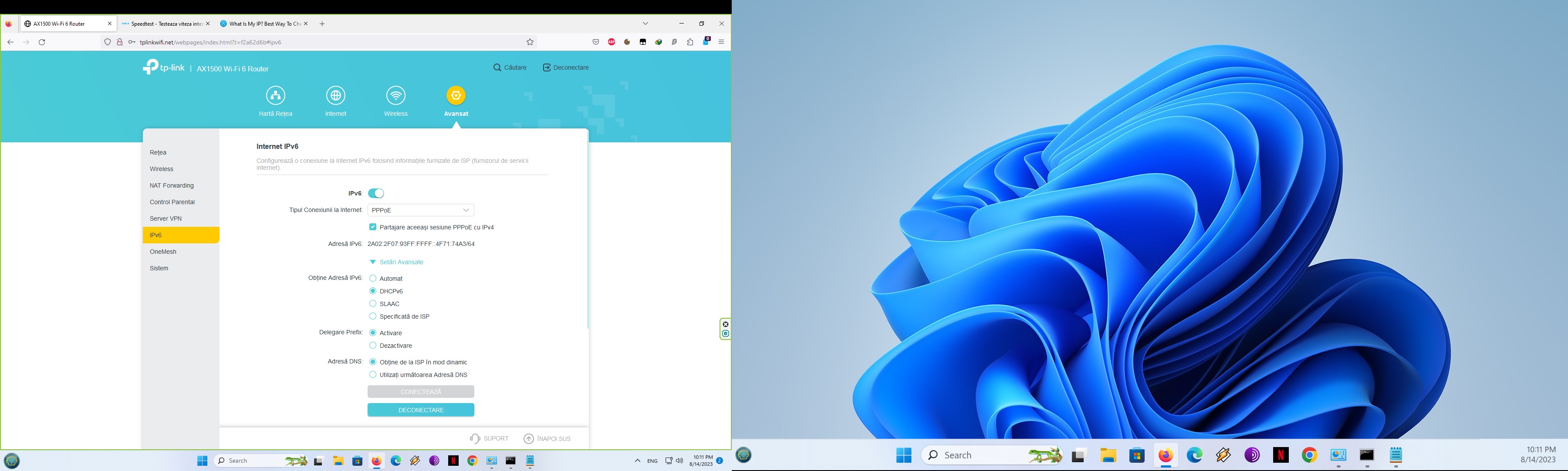

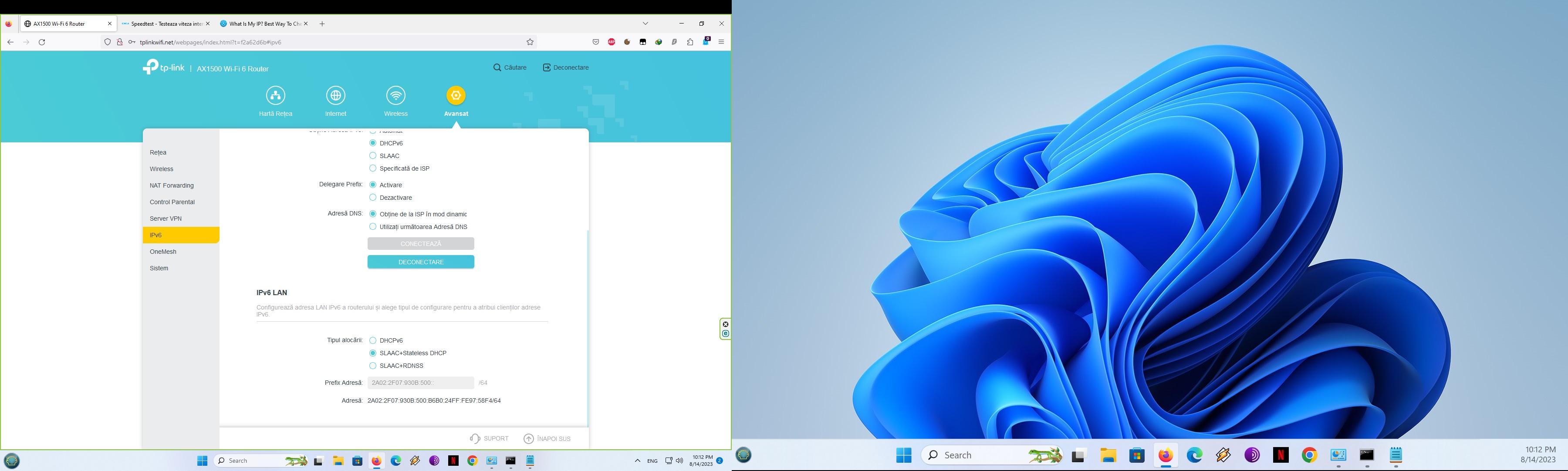

Hello. I have a gibabit connection from RCS&RDS(1Gbps). I would need a tutorial with pictures if possible to obtain IPV6 address outside. I have tried to go by some turorials on the net, but what I have found does not help me. I will send you 2 pictures of an IPV6 configuration on a router given by RCS&RDS(TP-Link). I need to reproduce this through some settings on mikrotik. Please help me. Thank you.

Not when you do not post documentation for configuration as given by your provider AS TEXT.
We are not going to decipher an unreadable screenshot.
I have a PPPoE connection from my ISP. All ports on the mikrotik are in bridge mode.

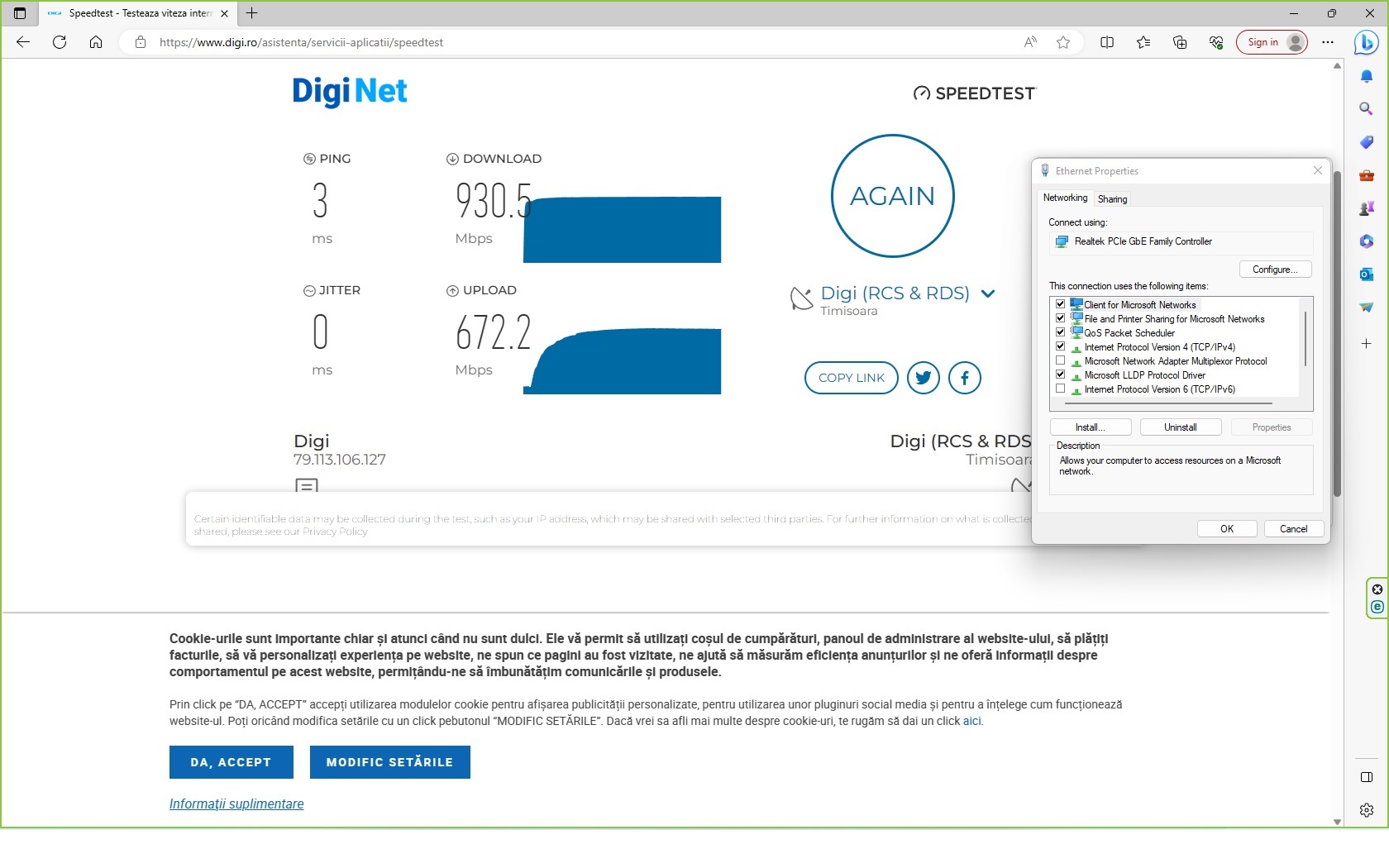

Thank you for your help. I managed to get the IPV6 address outside. However, I have a big problem. As long as I have the IPV6 address active the download and upload speeds decrease dramatically. If I only stay with the V4 IP everything is fine. Do you have any idea why this happens?

I checked and during the speed test the processor climbs somewhere around 73% getting these speeds: https://rcs-rds.speedtestcustom.com/result/e9ebd7d0-410a-11ee-8424-a7eb9afe3f6f
If I uncheck IPv6, everything is fine, the speed goes up considerably to 920Mbps/s. What do you recommend?
