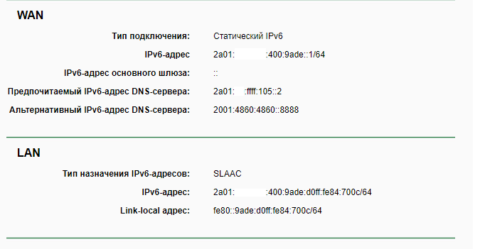

I’ve enter
IPv6 Address: I’ve Generate IP address from pool /64 or /56 at type it here
IPv6 Gateway: I’ve type there IPv6 address of Mikrotik Router from that vlan but it doesn’t accept it write error 51000 (default value ::slight_smile:
MTU 1500
IPv6 Primary DNS 2001:4860:4860::8888
IPv6 Secondary DNS 2001:4860:4860::8844
LAN Type SLAAC
Prefix i give prefix from vlan SLAAC Mikrotik Configuration and Subnet Mask /64

I’ve setup that way but it doenst work …
that configuration recived without router

Am I seeing it wrong, or do you really have 2a01:xx:xxxx:400:9ade::1 on TP-Link’s WAN and 2a01:xx:xxxx:400::/64 on LAN, i.e. same /64 subnet? That wouldn’t work well, you need different subnets.
For example, RB may have 2a01:xx:xxxx:400::1/64 on internal interface, connected TP-Link would have 2a01:xx:xxxx:400::401/64 on WAN and 2a01:xx:xxxx:401::1/64 on LAN. On RB you’d add:
/ipv6 route
add dst-address=2a01:xx:xxxx:401::/64 gateway=2a01:xx:xxxx:400::401
And it should work. Or you can configure DHCPv6 server on RB and let TP-Link get prefix from there.
And yeah, Ripper, if you will configure same /64 subnet on WAN and LAN sides, it’d be the same as 195.100.50.0/29 on WAN and 195.100.50.0/29 on LAN: your router won’t route your traffic to same network via different interfaces, so grab /64 subnet from /60 “special ptp prefix” and grab /56 except that /60 to your clients. Subnets must be different.
