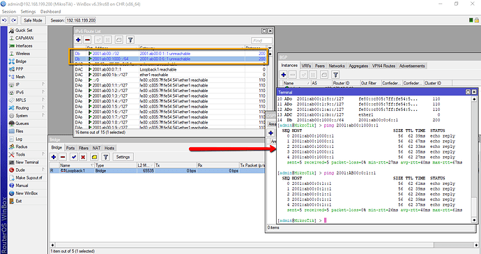

I am trying to build up a IPv6 lab environment and using GNS3 for that. Mikrotik OS i am using is 6.39rc68 (testing). IPv6 setup works fine with the CISCO OS configured in same LAB scenario but when after adding Mikrotik OS 6.39rc68 (testing) i discovered iBGP routes are showing unreachable. I found some old thread about the same issue and not sure its fixed by the OS i am using or i need other version. Please suggest me how to fix it.

But when i ping

It seems i am getting ping reply.

You’re using ancient version of ROS. Upgrade to stable (currently 6.43.11) and try again.
Currently it is not possible to resolve recursively to link local gateways.
We are all waiting for ROS v7 to solve this issue.
http://forum.mikrotik.com/t/bgp-ipv6-route-reflection/89173/1
