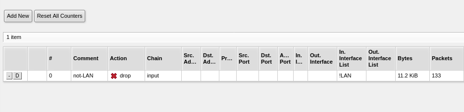

There was nothing in the ipv6 firewall section. I wanted to protect the RB760 itself and only itself
as the connected machines have their own firewalls and policies. So I made the following rule:
and then scanned the ND ::1 via http://www.ipv6scanner.com/cgi-bin/main.py
…which produced “filtered” for all common ports :smiley:

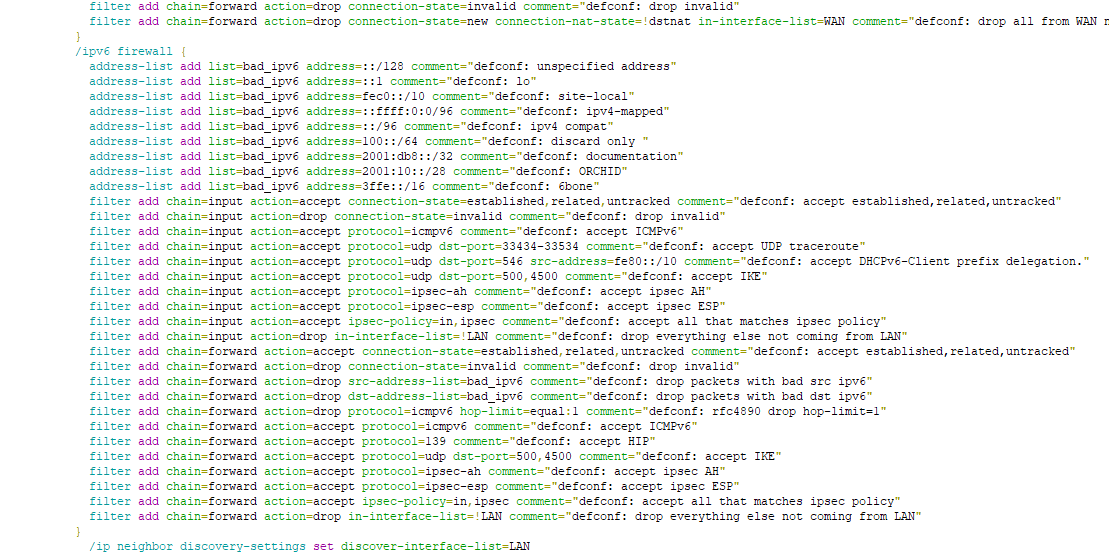

There are default IPv6 firewall rules for the default configuration, if you reset the router’s configuration in RouterOS7, or in RouterOS6 with the IPv6 package installed. The rules look similar to those here, but not identical: https://help.mikrotik.com/docs/display/ROS/Building+Advanced+Firewall. For instance, the raw rules are not used. When you run the command
/system default-configuration print
as suggested by @mkx, you can see these rules included in the output. That’s what you should copy if you don’t want to reset your router back to the default configuration.
The single rule from your screenshot is not good enough, because it blocks all IPv6 WAN communications of your router, it blocks all responses, not just incoming connections, and doesn’t protect clients in your LAN network, which use the chain “forward”. IPv6 addresses in your LAN will be accessible from the internet with no protection. Also please note that ICMP is very important for a functional IPv6 and should not be blindly blocked.

I want to block all connections from the internet to services on the router only, but I also want to access those services from my LAN,
hence the !LAN rule. These two things are my primary concern. I’m not bothered if I can’t ping from the router itself. (but see edit)
edit: I’m wondering how the ipv6 got started in the first place. Probably because I enabled the rule after ipv6 started working, and haven’t rebooted it since. in other words, yeah I realise ipv6 probably won’t work after I reboot unless I sort the rules out effectively, at least for icmpv6, because, as you rightly point out, in v6 icmp is a requirement for it to work.
Then you can probably ignore the MikroTik’s default rules for the forward chain (but it’s still good to block forwarding for packets with source or destination in the “bad_ipv6” list). As for the input chain, if you block everything not from the LAN interface list, DHCPv6 prefix delegation won’t work because that requires that the router accepts incoming UDP packets on port 546 from the link-local address range on the WAN interface. So, you should include at least the line with the comment “defconf: accept DHCPv6-Client prefix delegation.” in front of your drop-all input rule.
I still think it’s not bad to copy the rules from the chain “input”, and remove the rules related to IKE/ipsec/esp/ah if you want. If you need to disable ICMPv6 echo (ping) but still allow the other vital types, you can copy the raw rules from the bottom of this page and disable the raw icmp6 echo rules https://help.mikrotik.com/docs/display/ROS/Building+Advanced+Firewall#BuildingAdvancedFirewall-IPv6RAWRules. But IMHO there is no needs to block ICMPv6 echo to your router.
