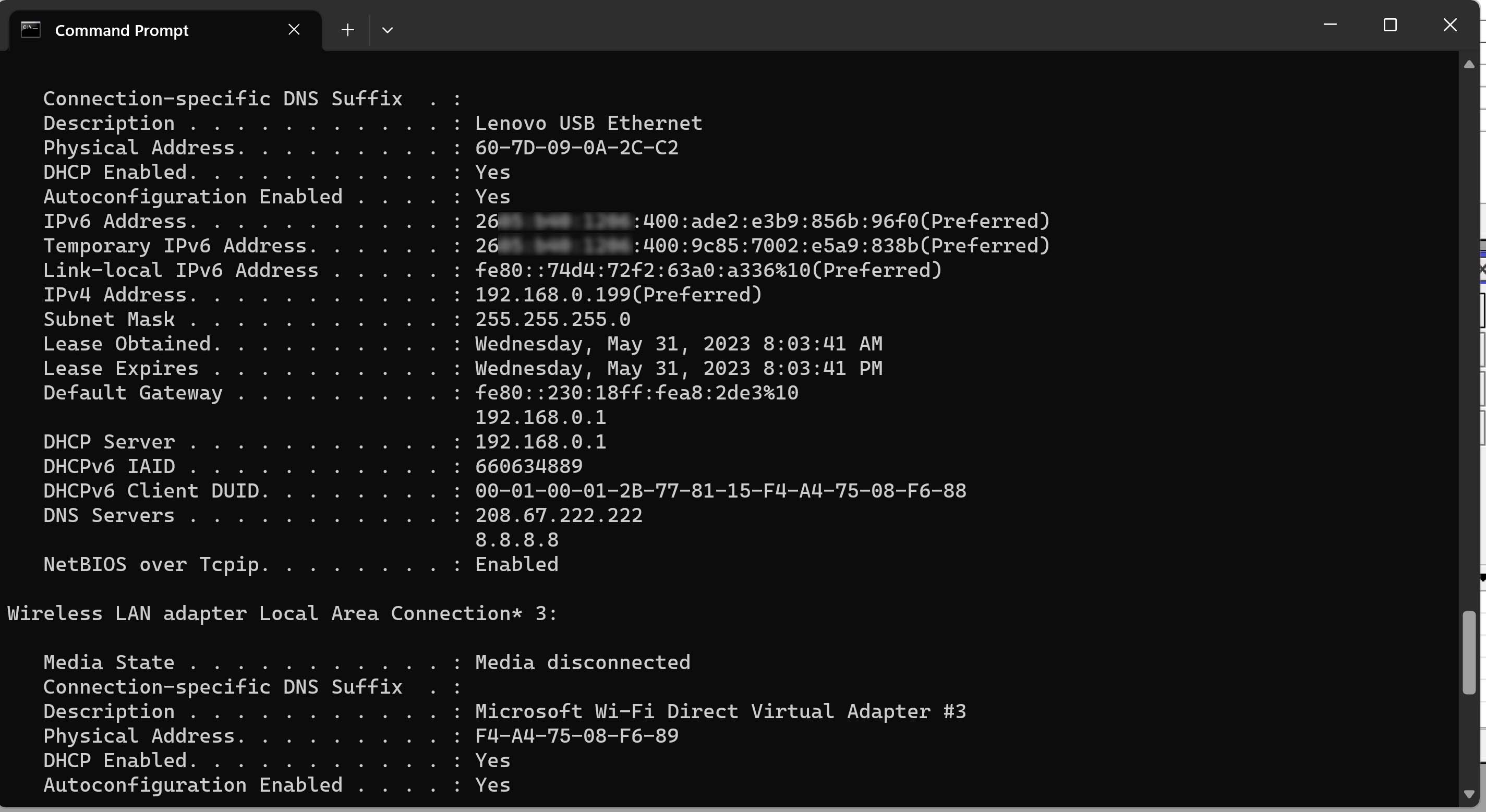

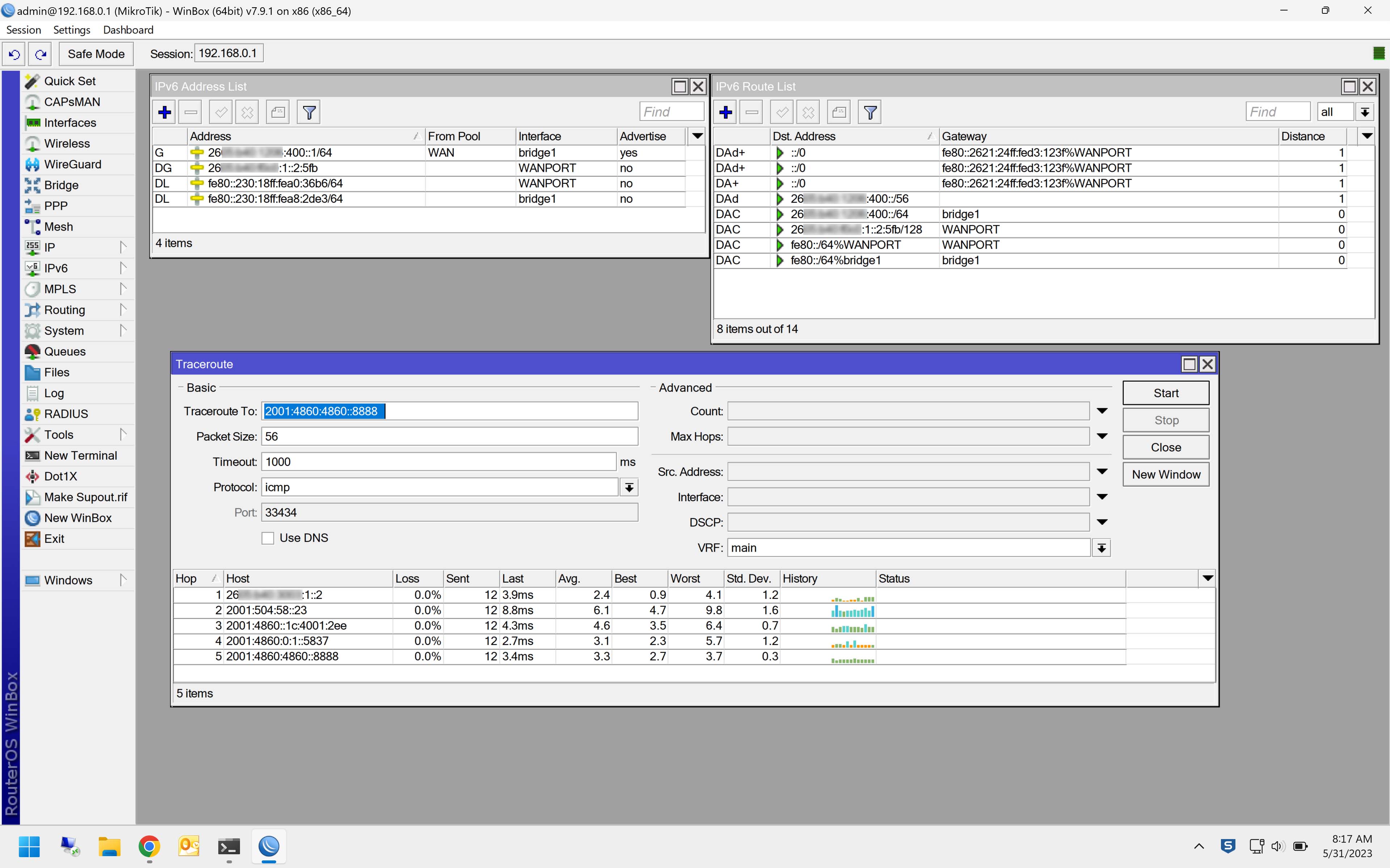

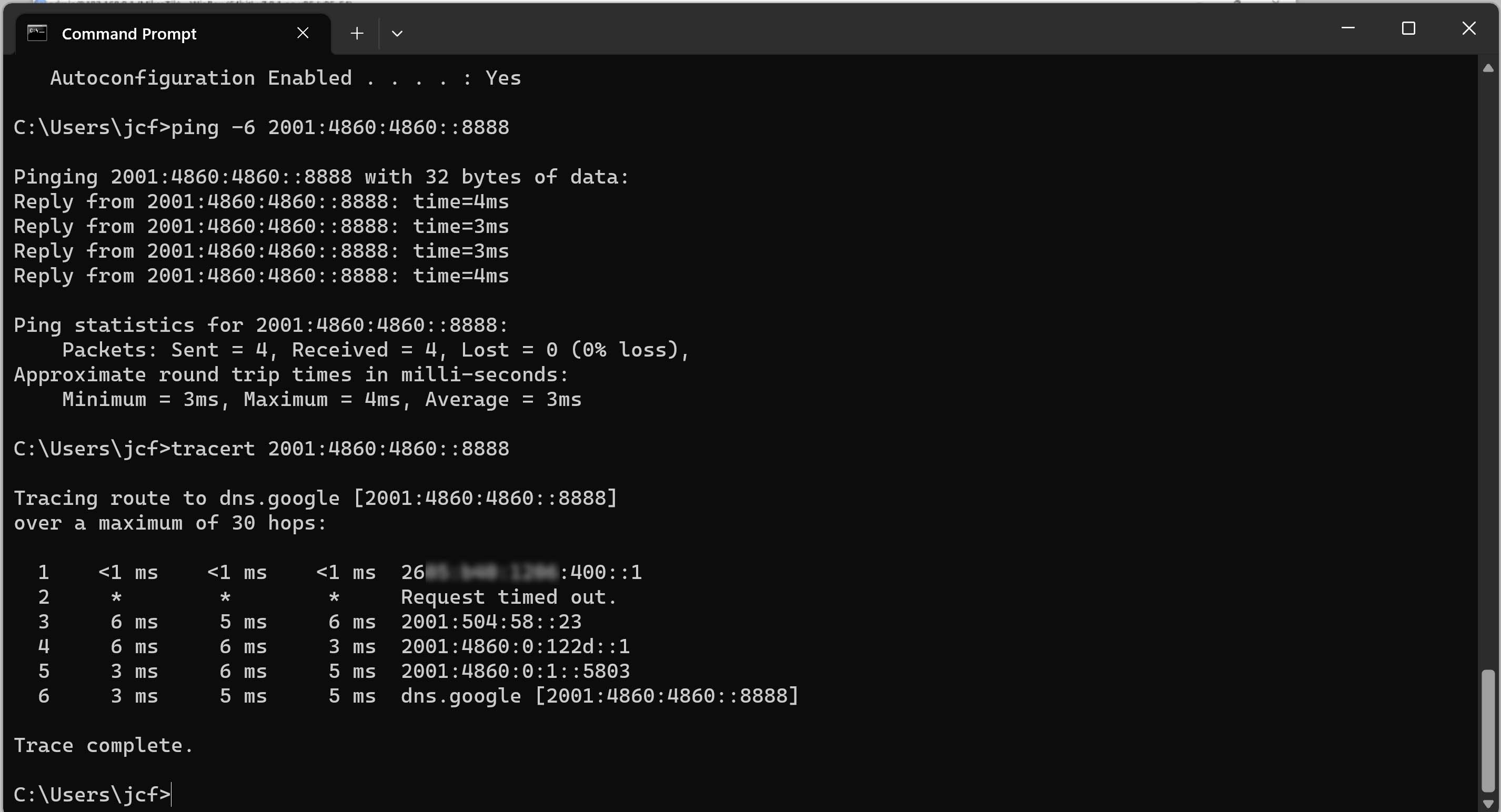

A lot of things work (though possibly the router must sit for a bit before they start to work). For example, ping and traceroute from the Winbox Tools work fine (Winbox1.jpg). The PC plugged into the router gets valid-looking IPv6 addresses (PC ipconfig to routerOS.jpg) and (remarkably) the PC does a working ping6 and a mostly working tracert (PC to routerOS.jpg).

My best guess is that since your PC doesn’t have an IPv6 DNS server the browser retrieves IPv4 address (the type=A record) which exists but presumably is ignored by the server.
To verify that, you can statically configure IPv6 on your PC to use a public IPv6 DNS server, e.g. 2620:fe::fe
