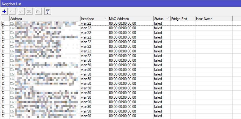

Good morning, old topic here.
Any progress?
I am facing same issues with several hosts.
