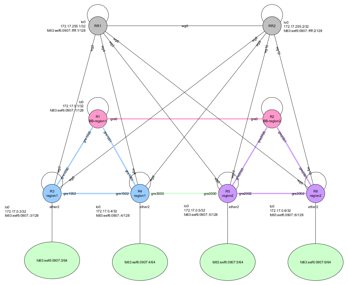

Hi all, I’m testing a design in the lab and am unsure whether I’m making a configuration error, something I’m doing isn’t actually supported, or I’m hitting a bug.
To start, here is the design. It is all virtualized CHRs running 7.8stable. The general idea is that there are two regions being simulated (region 1 in blue on the left, region 2 in purple on the right).
rr2.txt (2.07 KB)
All of the routers in each region have a full mesh with each other and comprise an OSPFv3 area. One router in each region serves as an inter-region backbone router (R1 in region 1 and R2 in region 2) and is an OSPFv3 ABR between the backbone area (in pink) and the OSPFv3 areas in each region.
From every non-backbone router (R3, R4, R5, R6) to RR1 and RR2, there are Wireguard tunnels and static routes to loopbacks configured. Between the loopbacks, the routers run iBGP with RR1 and RR2 acting as route reflectors. No OSPFv3 is configured as RR1 and RR2 are never intended to handle traffic. There is a backdoor link (gre3000) between R4 and R5 but it can be safely ignored as it is not currently configured.
MPLS and LDP is configured on all of the routers (not RR1 and RR2, obviously). The “customer” LANs (light green at the bottom) are redistributed into BGP and carried to every PE router (R3, R4, R5, R6) but not the P routers (R1, R2). Other than some oddities like the full mesh and the use of tunnels, this is a pretty canonical BGP-free MPLS core design. All of the OSPFv3 and LDP configs appear to work.
