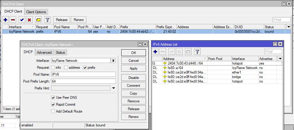

i have added that, but it somehow does not work.
i have a hotspot network and i want ipv6 to be available on that network. where am I wrong?
I’d first verify that router itself has IPv6 connectivity … by assigning IPv6 address to a wired LAN interface.
I can’t comment on hotspot, I’ve no experience on that. Hopefully somebody else chimes in. But the address on the hotspot interface loojs suspicious to me with the double colon at the end. I’d try to get something other than zero in the least significant 4 digits.
It’s also suspicious that the manually added address uses completely different subnet, not related to prefix from DHCPv6.
Thank you all, it is working now Fine.
