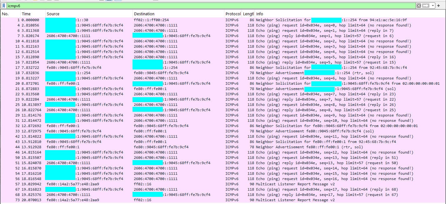

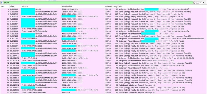

I captured packets on both the HE tunnel interface (HET) and the container interface (vethPihole) where I’m pinging from.
The HET capture shows all echo requests and a reply for every one of them coming back.
The vethPihole capture shows all the requests leaving (of course) but is missing most of the replies. Nothing else comes in to replace them or anything like that; they are just missing.
I also see the ‘destination unreachable’ packets being sent out of HET from the router, matching the replies which do not make it to vethPihole.
The router is indeed ‘losing’ packets somewhere between accepting them from HET in the forwarding rule, and actually forwarding them to vethPihole. Moreover, it is reporting back to the test address that the destination address (by which I think it means my vethPihole address now) is unreachable (code 3)
One possibly interesting thing is the source/destination addresses that I see. The test address is as expected of course. The container is using a generated address from the prefix on that network instead of the one I assigned the interface in the container config. Regardless, that’s fine and it’s consistent and works (if we ignore the random ping failure). The ‘destination unreachable’ packets though are being sent to the test address from the HE tunnel endpoint address here, not the prefix I’ve assigned everywhere else which is different to the tunnel’s prefix. I guess that’s not important since it’s the router sending it and it has that address on the endpoint so can use it.
The issue is nothing to do with running the in a container I don’t think. I see exactly the same if I try pinging from a PC on my LAN (same prefix as the container in the router).
I’m wondering what to do next now…

HET Capture
vethPihole Capture
(I hope all of that formatted OK… I don’t like this forum software.
Investigating further… the IPv6 neighbour list clearly shows the vethPihole with the correct IPv6 and MAC address. It goes from Stale to Reachable as soon as I start pinging from the container, yet the replies still get mostly dropped as ‘destination address unreachable’.
Also from that container, I can ping a PC on the LAN by its IPv6 address with no failures. Pinging the router’s IPv6 address on that same LAN interface from the container completely fails. Yet pinging the container Pihole’s IPv6 address from another router terminal works 100%.
Remember also that the exact same ping loss/unreachable issue happens if I ping from a PC on the LAN. It’s not an issue with the container.
It’s looking like something to do with neighbour discovery and the neighbour table on the router… but I haven’t changed anything in that to break it, and it still works randomly.
