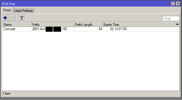

Here’s how you know you got the /60 from Comcast:
Note that the pool prefix is /60, but the prefix length is /64.
Prefix length = the length of prefixes assigned from this pool.
Since you’re assigning directly to local interfaces, /64 is correct for that.
(shorter prefixes like /63 /62 etc would be used for assigning to other routers in your own network which would request prefixes from this router, but that’s not your scenario)
