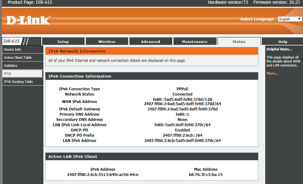

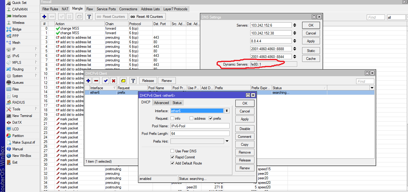

I have configured IPv6 PPPoE and DHCP but i was got issue on both for clients end not able to get DNS and in PPPoE Gateway & DNS not coming.
Below attached PPPoE client and DHCP client images.

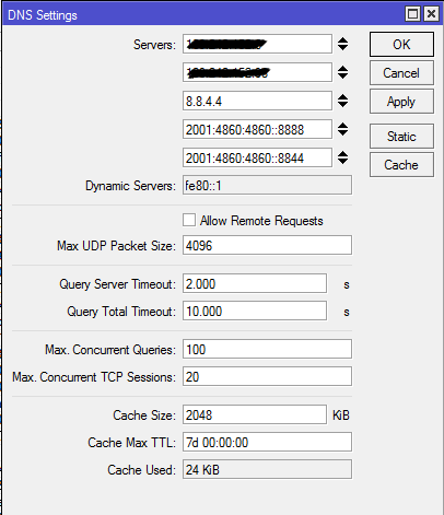

Your CCR shows fe80::1 as a dynamic DNS server. It looks like it might be handing that down to the D-Link client device, which will not work. Your CCR router is probably configured to pull that from an upstream device. You may have to switch that off, for instance by disabling “Use Peer DNS” in DHCPv6 client settings if your CCR is getting IPv6 through DHCPv6.

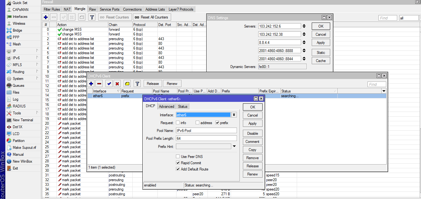

I have to turned off the " Use Peer DNS" in the dhcp client settings at clients end or on my server end? Below i have added the image of it, There Interface Eth6 is my up link.
can you suggest on this.
here it’s only server not client.

I’ve circled the problematic DNS server in the screenshot above and posted it back.
That fe80::1 is not supposed to be there. You are getting that dynamically from somewhere and your CCR router is installing it and it seems to be messing up handing out the correct DNS servers to the clients because it is handing it out instead of the static ones you specified. You’ll need to figure out where that is coming from.

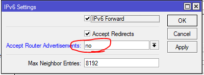

So the only thing I can think of is that you are getting DNS through RA packets.
On your CCR, go into IPv6->Settings and make sure that “Accept Router Advertisements” is set to “no”.
Thank you very much there in my devices it was “Yes” now i have changed it to “NO”.
I have got DNS in PPPoe Dial up in Dlink Router.
Kindly give me solution for Gateway also in PPPoE.
Coming to DHCP still same issue not able to get DNS and Gateway.
Sorry, what is the problem with the gateway exactly? The device should simply use the PPPoE interface as the IPv6 gateway. The CCR shouldn’t have to provide a gateway to the D-Link. Have you checked to see if the IPv6 internet works through the D-Link now?

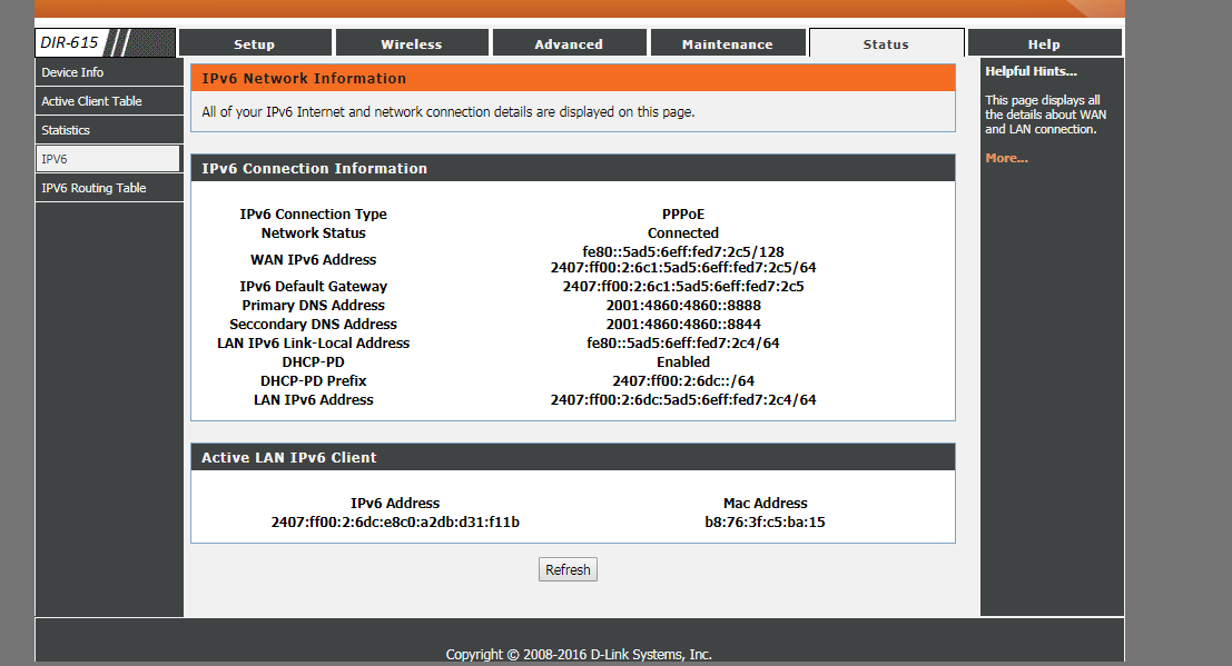

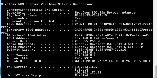

I have dial up from Wifi router and got below IP and DNS, Pd prifix etc…

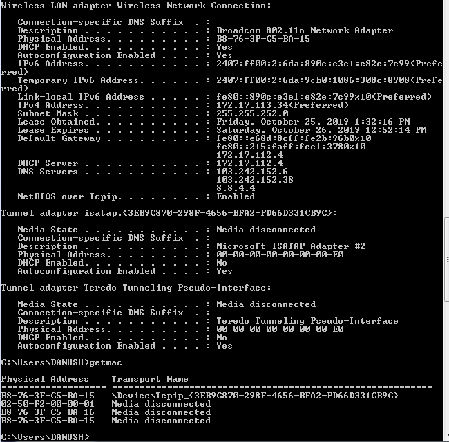

When i connect PC i have got Only IP of IPv6 all other came with IPv4 as below .
Is this working fine or i have to do anything else.

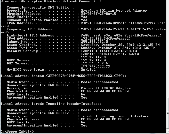

Coming to DHCP configuration i have issue with DNS and Gateway Like below.
Your MikroTik config is fine now. The computer is not getting DNS but that is the D-Link’s fault, something is wrong on the D-Link. Either the D-Link is not handing out the DNS servers in the RA packets or it is not acting as DHCPv6 server on the local network. Either way that is a D-Link problem and nothing to do with RouterOS.

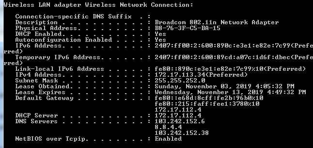

In this second image you seem to be on a network with two routers connected simultaneously, so you are getting two gateways. The solution is to not plug in two routers in the first place.
