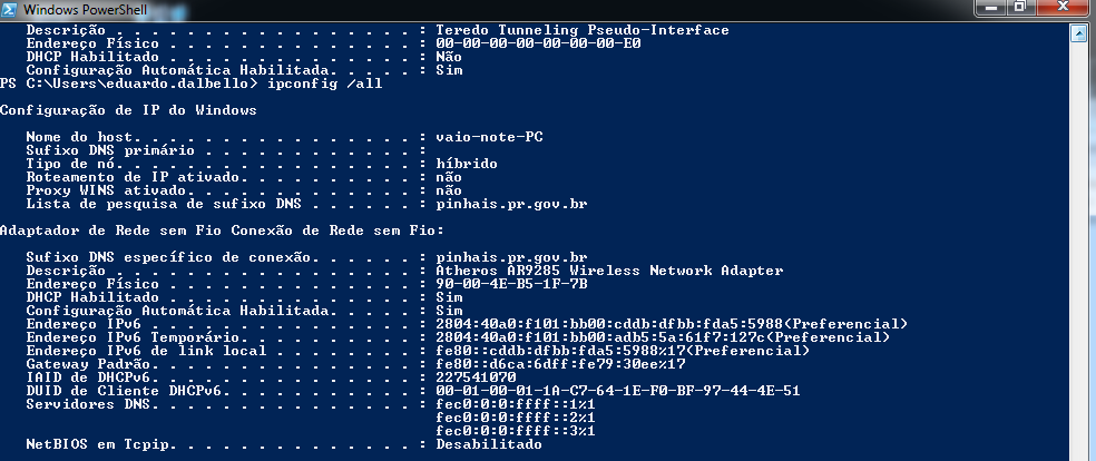

I’m testing on windows with only the ipv6 and I noticed that he put the dns
DNS servers. . . . . . . . . . . . . . . : fec0: 0: 0: ffff :: 1% 1
fec0: 0: 0: ffff :: 2% 1
fec0: 0: 0: ffff :: 3% 1
when you don’t have ipv4 enabled.

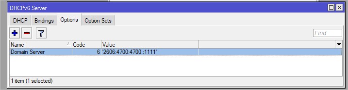

On the dhcpipv6 Server and i created options code 6 pointed to ‘2606: 4700: 4700 :: 1111’
End set dhcpserver ipv6 options the option created above but it does not pass the specified dns to the station
You need to use code 23 for that…
However, you can also add one of those 3 fixed addresses (a Windows thing…) to the bridge interface as a static address.
(assuming you have the mikrotik DNS resolver configured)
