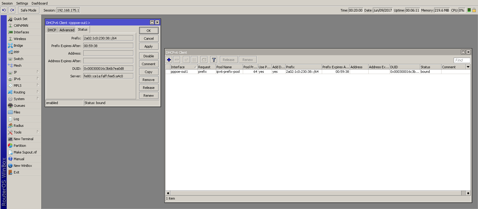

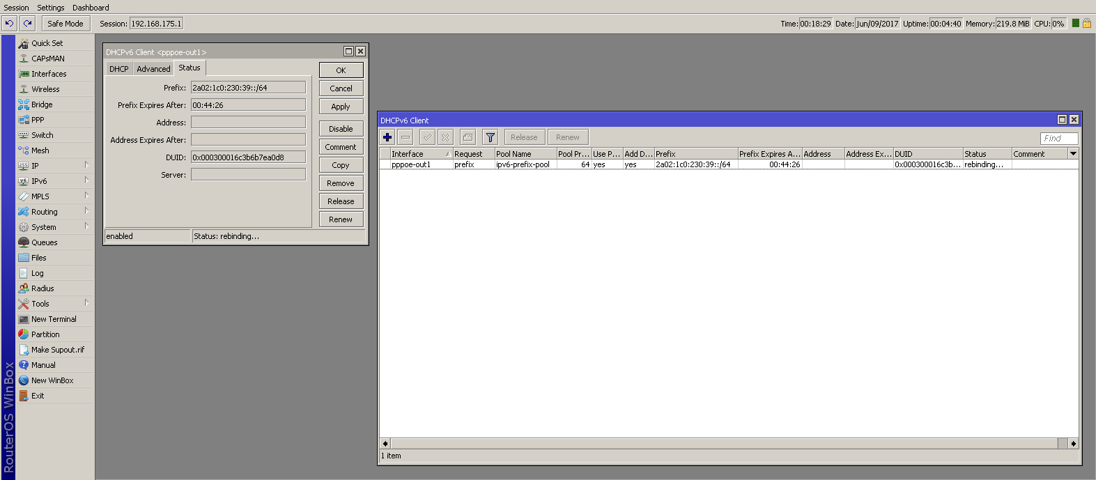

There is a bug with IPv6 DHCP client over PPPoE (It’s only tested with PPPoE). After PPPoE disconnect or router reboot it tries to rebind, but the rebinding is unsuccessful. The PPPoE server is HW router providing PPPoE with IPv6 using DHCPv6 and SLAAC simultaneously. If I manually release the pool, everything is fine and the pool is assigned correctly. If I wait the lease timer to expire, the renew is done successfully.

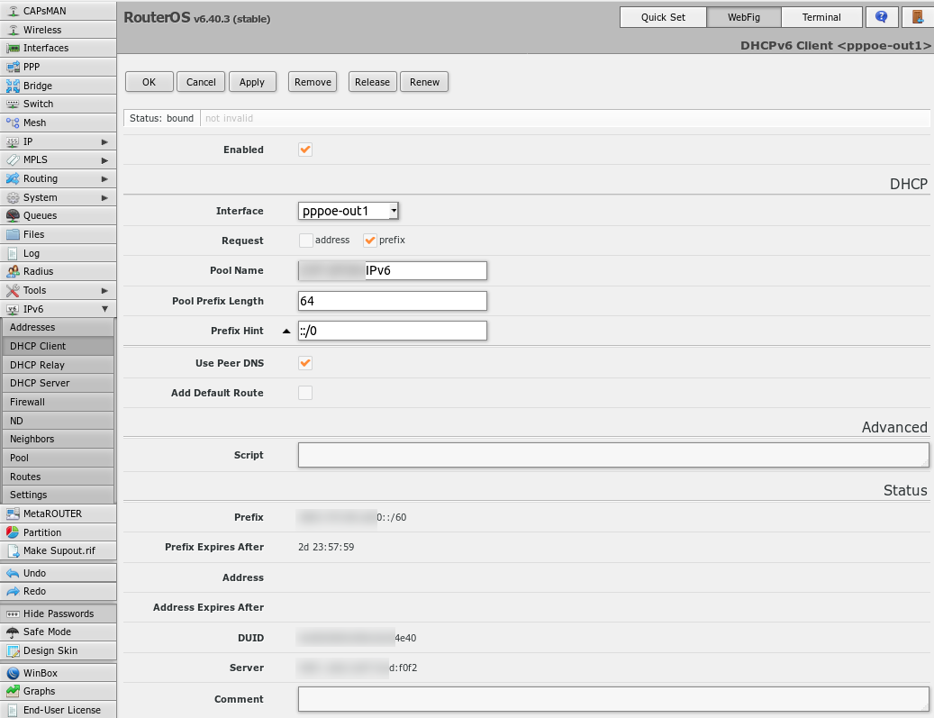

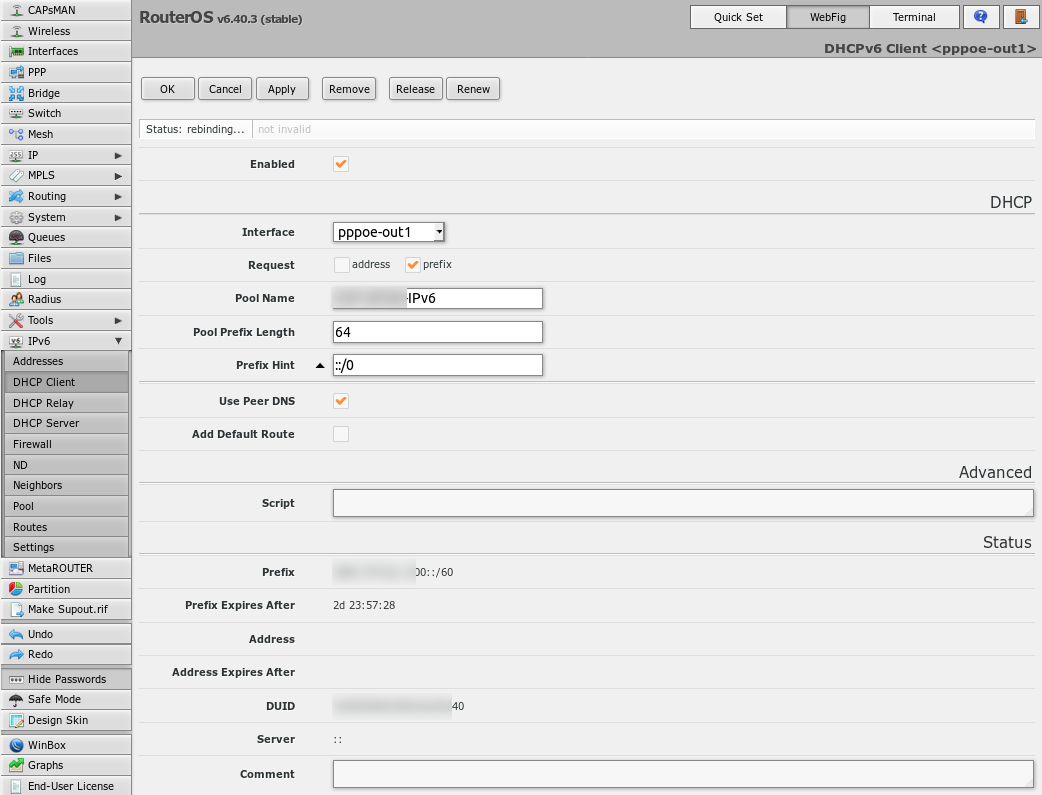

Same problem here, also with PPPoE. After a reboot, the IPv6 pool doesn’t get created, and the DHCPv6 client shows this:
I have to manually hit the “Apply” button (without changing any settings), at which point it binds correctly:
