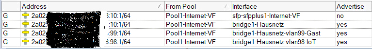

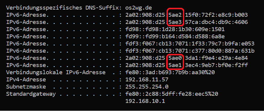

After the update to 7.12 I have similar experiences with Prefixes deployed over VLAN borders.
All 4 prefixes are deployed in my home network, not only in the correspondib VLAN´s.
This has worked without problems with 7.11.2 and before.
The correct prefix assignment can be seen in this picture:
I´ve already opened a support ticket SUP-134767 to clarify if this is anwe bug in 7.12 or 7.13
