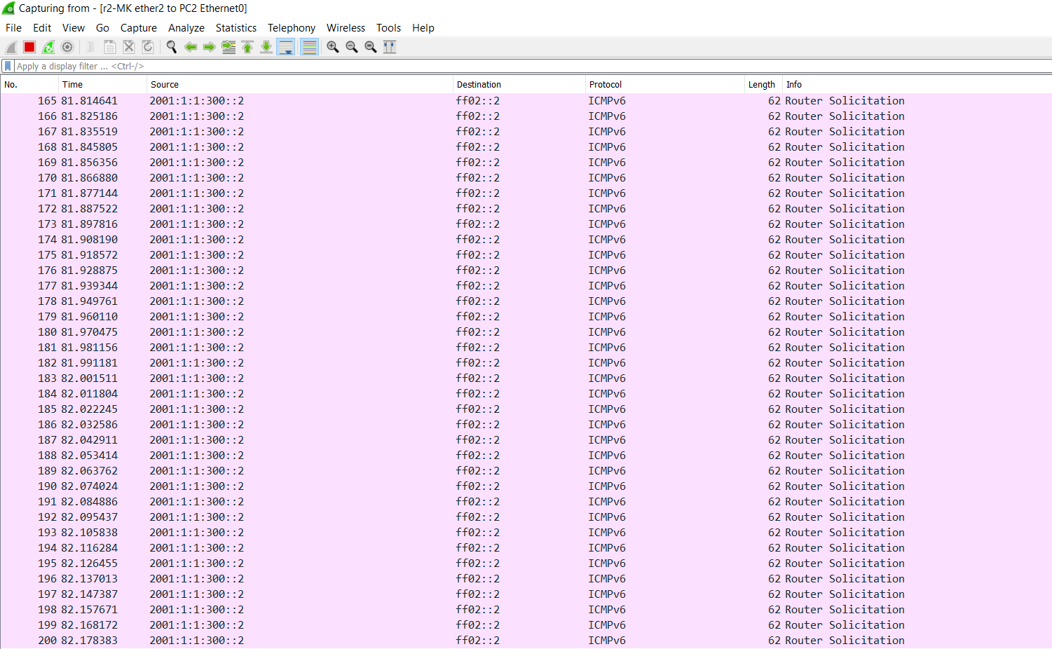

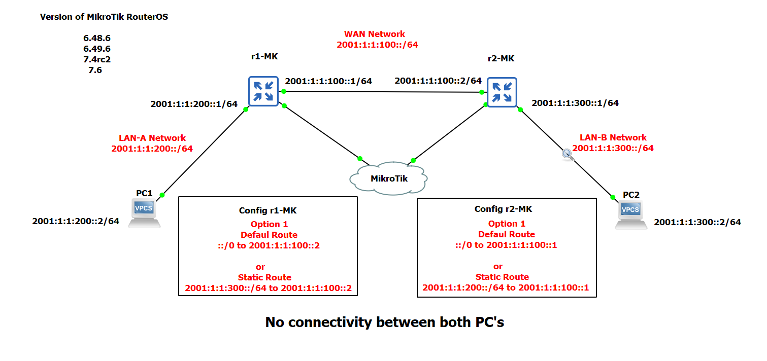

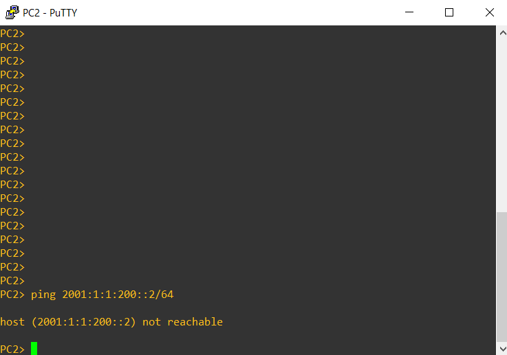

Currently I have the following problems with a basic IPv6 scenario, I share the images of the implemented topology, the problem is that I have no connectivity between the PC’s of both networks, I also share that when PC2 tries to have connectivity with icmpv6 PC2 sends to the router solicitation and does not receive the router Advertisement from the Gateway with the information of the destination host.

The first thing i’d try is a traceroute from either PC to understand what hop the traffic dies at.
If you’re using the virtual PC node with EVE-NG, I don’t believe that supports IPv6 SLAAC so make sure the PCs have a valid GUA address and can ping their gateways.
I have done the labs with GNS3 and on physical routers, additionally I am configuring the WAN and LAN interfaces with GUA and it is static configuration.
Additionally when I do a tracert from PC1 to PC2 I only get as far as the second router.
When the PCs do icmpv6 to their gateway they send in RS but do not receive the RA.
