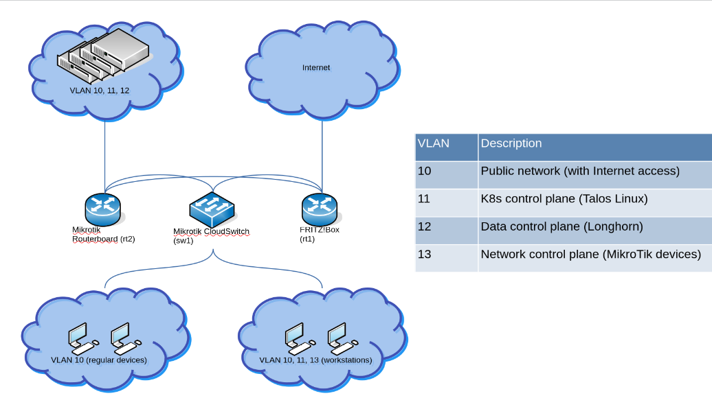

Rather than MT RA daemon broadcasting (well, multicasting) out of the wrong interfaces, I would be leaning more in the direction of a possible misconfiguration in your bridge VLAN filtering config that is causing traffic to leak between VLANs. But you didn’t include your whole config, so…
A drawing:

Hmm, that mostly looks correct. The other thing that gives me pause is that the ‘wireguard’ interface wouldn’t be a VLAN, and yet you said one of the VLANs on the client was SLAAC’ing from the ‘wireguard’ prefix. I also failed to notice until just now that you had previously written that the RAs you are packet-capturing on the client side actually contain two prefixes within a single RA packet…am I reading/understanding that right? You aren’t seeing two separate RA messages, but a single one advertising two prefixes within it?
If so, then the following suggestions/tests are likely a waste of time, but if not, I was going to suggest:
…setting ‘untagged=“”’ on your very first /interface/bridge/vlan entry. You don’t need to do that; just rely on the ‘pvid’ setting under /int/bridge/port to take care of that for you, which will cause that bridge port to be dynamically added to ‘current-untagged’ for that VLAN-ID. (Same for the bridge/CPU-facing switch port, when setting ‘pvid’ of the bridge itself under ‘/int/bridge/set pvid=’) In your case I highly doubt this is causing any issues; I am just inherently suspicious when I see anybody manually setting VLANs to ‘untagged’, since one wrong slip-up when manipulating that setting can quickly twist you up in knots.
…try to manually override the MAC addresses on the vlan interfaces on rt2, providing each one with a unique MAC. (Which should also cause rt2 to generate distinct fe80:: link-local suffixes per VLAN as well.) Then re-packet-capture the RAs on the client sides, and see if you are ever seeing RAs from the “wrong” MAC/link-local address showing up on a given VLAN. (If there is no VLAN leakage happening on rt2, and instead rt2 is in fact sending the wrong prefix(es) in the RAs it is transmitting out, then the source MAC will always be the correct one for that VLAN.) [EDIT: I forgot that ‘mac-address=’ is not an override-able VLAN interface parameter on ROS; however, you can work around this by creating one new bridge per VLAN, adding that VLAN interface as the sole member of that bridge, and changing the bridge’s MAC address. Also make sure to move any other config that previously referenced the VLAN interface directly – for example: IPv6 addresses, ND config – to instead refer to the new bridge interface.]
Are the RAs with the additional incorrect prefixes in them a unicast response to a RS emitted by the client(s), or are they within the regularly-transmitted unsolicited multicast ones? (Or both?) What do the router solicitations sent out by the clients look like…have you tried capturing those? What happens if you try to remove the client from one of the two VLANs it is on (like, actually turn down e.g. end0.11 on the client itself, but leave end0.12 up, not just removing that port from VLAN 11 on the rt2 bridge side)…does the behavior change?
If I understand correctly, your complaint is that RA received by a host on vlan11 contains an additional Prefix Information option (3) with prefix that does not belong to the current link.
Per RFC 4861:
A router SHOULD include all its on-link prefixes (except the link-local prefix) so that multihomed hosts have complete prefix information about on-link destinations for the links to which they attach.
However, it does seem wrong that, per tcpdump, the off-link prefix for wireguard is advertised as both on-link and for SLAAC.
Sounds like a strong case for a bug report.
I’ll try to reproduce the issue, but I can’t pinpoint what exactly the state was that caused this initial reported situation. By mistake I did have configured sw1 to obtain a prefix delegation from rt1, that Cloud Switch also had forwarding enabled for IPv4 and IPv6. That’s not needed, since it acts as a managed layer 2 switch. But as the tcpdump shows, the traffic came from rt2, not sw1. So I’m not sure how relevant it actually is. Maybe it also used RA to become a gateway or something like that. But then again, sw1 does not have the Wireguard network in its delegation. So that might have caused totally different issues (if at all). At the moment sw1 does not get a prefix and is not forwarding traffic anymore (as far as it did).
So, at the moment the IPs seem correct for my workstation and the Talos nodes. This situation is also stable, for now.
However, I did see this yesterday, but that too isn’t showing up anymore. Maybe it only happens when I reboot the nodes/network devices. I’ll test that.

The only time when I saw multiple prefixes being announced is when there indeed were multiple prefixes on the interface.
At another site we have two ISP uplinks with IPv6 and I experimented with announcing both their prefixes on the local network.
That worked OK, but it did not look like the client devices made sensible use of it, so I discontinued that.
Also in old RouterOS versions there was the problem that when an address was withdrawn and another address assigned, it would continue to publish the old address. However that was fixed way before 7.18.2
But those were then prefixes from 2 different delegations? Because I didn’t see prefixes from the other Mikrotik. Only from rt2 itself, on interfaces that weren’t in the VLAN that should get those prefixes.
I haven’t been able to reproduce it so far. I rebooted all devices. Nothing. I’ll try later to setup sw1 again as it was, with forwarding enabled.
Interesting. Came across this issue. Updated my mikrotik and this went away. I was pulling my hair out trying to figure out why VMs were getting prefixes meant for other vlans. I think this was fixed in 7.20.1:
ipv6,ra - fixed prefix unlinking from interface on configuration change and stop deprecating prefixes when the validity lifetime expires;
