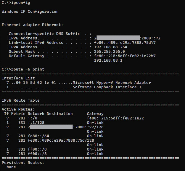

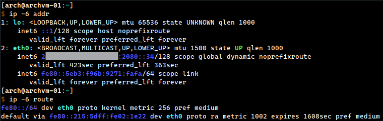

And neither do Windows nor Linux automatically add /64 connected routes for /128 received IA_NA addresses:
This is not related to DHCPv6, but is the result of you having added this:

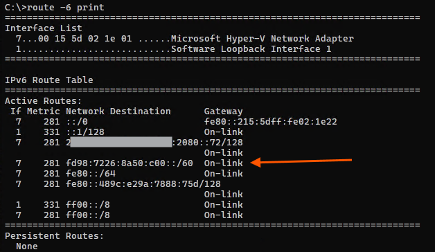

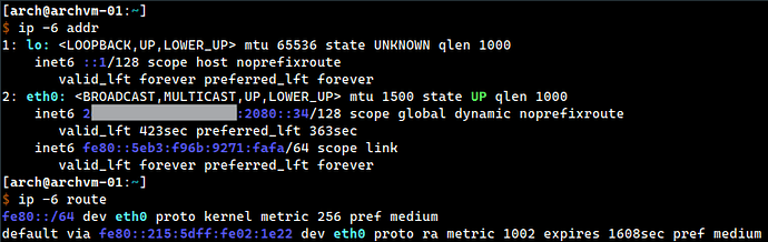

If you set that to prefix=none, then you'll see that both Windows and Linux clients will no longer add the /64 connected routes. In fact, if you add an /ipv6 nd prefix entry with other prefix length, totally unrelated to the DHCPv6 one, with autonomous=no, those OSes will also add corresponding connected routes:
Result:
The difference to RouterOS is that RouterOS ignores received prefixes in RA (not related to DHCPv6) with autonomous turned off, because it has no use for them (no SLAAC). RouterOS does not install connected routes when it has no corresponding address assigned to the interface under /ip address or /ipv6 address, with the same prefix length as the address. If it only has a /128 address assigned to it under /ipv6 address, you won't see any dynamic /64 connected routes appearing.
