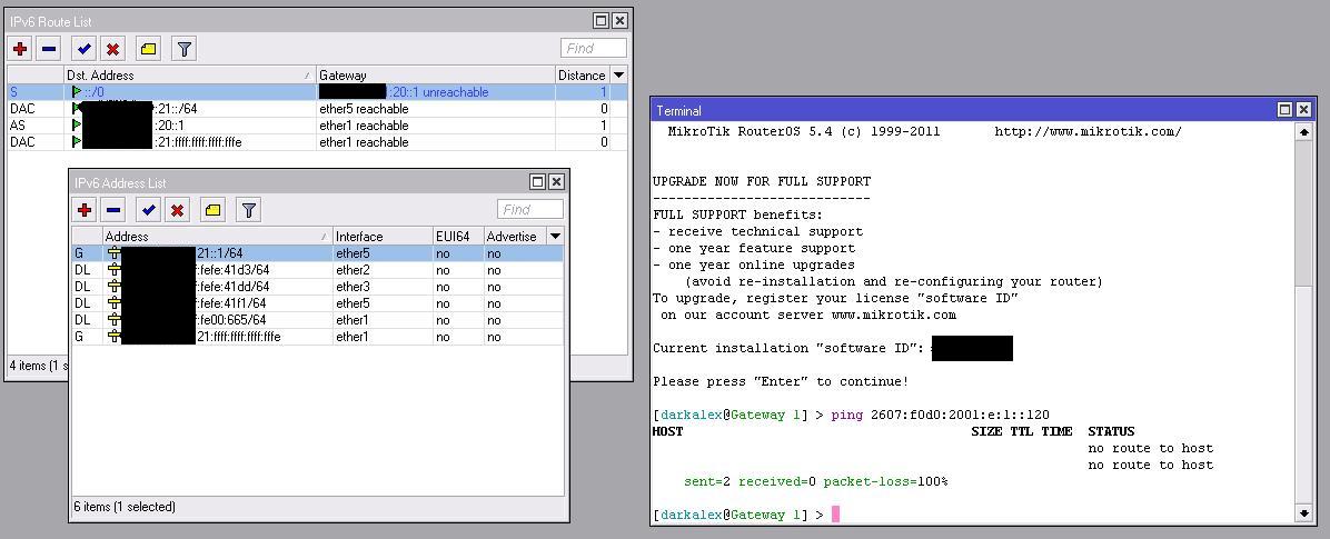

Here is what I tried:
I am now able to contact each of my servers from each other but no connectivity to internet…
It doesn’t find the GW but as you see I added a host route for this purpose. In my opinon a ROS-dault?

A setup like
gw-ip/128 via Ether1
mysubnet::/64 via Ether5
::/0 via gw-ip
And Ether1 has an IP of mysubnet
