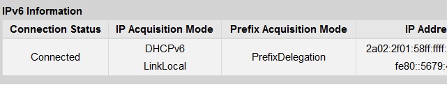

Just got my hap ac2 and I’m trying to get IPv6 to work. My ISP is providing a GPON with router function and I need to keep this online. They provide dual stack IP v4 & v6 as per the attached picture and the setup is: GPON (handles PPOE and DHCP server for MIKROTIK) ------> MIKROTIK HAP ac2 ------>LAN clients. (cascading dual NAT, I know!, I may consider switching the GPON to bridge and handling PPOE on the tik at a future time)

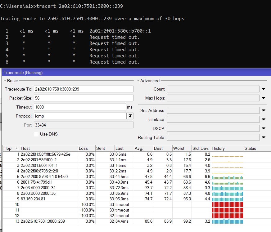

But even with what you have now, things shouldn’t be broken, so you need to test what exactly is wrong. Start with traceroute to some IPv6 address on internet (e.g. 2a02:610:7501:3000::239, which belongs to forum.mikrotik.com), from both PC and hAP, and see what it does.
Thank you for the answer.
Looks like it’s stuck at what looks like the router assigned ipv6, I’m also stuck…
If it works from router, but it doesn’t work from device behind router, even though it seems to have address and everything, it looks like something wrong on router. Firewall would be good candidate, but I assume you didn’t touch it, or did you?

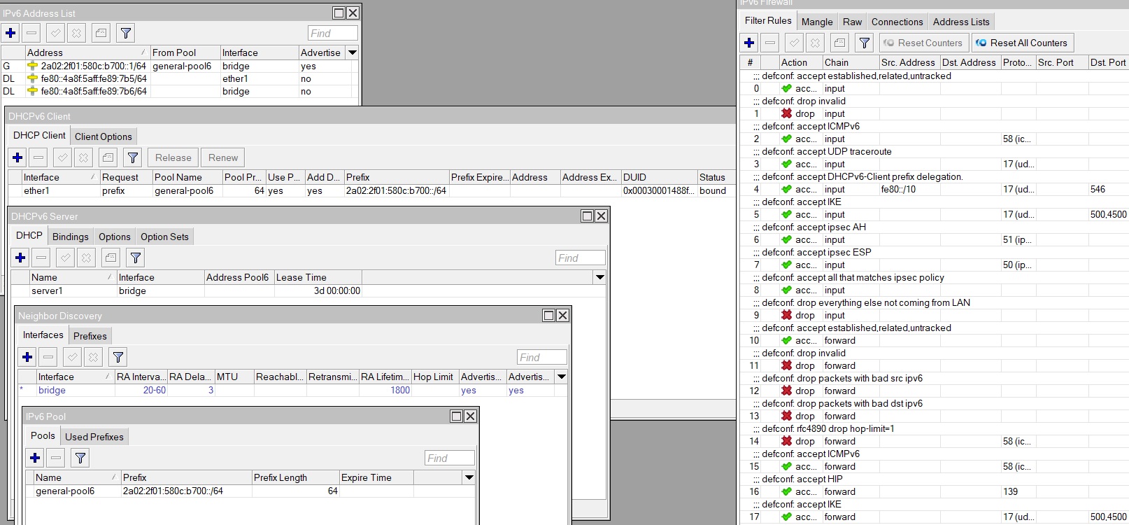

You can try to export your config:
/export hide-sensitive file=yourconfig
and post content of resulting yourconfig.rsc in code tags, maybe there will be something visibly wrong…
Looks like if I disable “/ipv6 settings set accept-router-advertisements=yes” I get 100% loss on IPv6 traceroute from the tik
So here is my export.
The firewall is the default for both IPv4 IPv6.

I don’t see any obvious problem. Try to examine what exactly happens. Start ping from client to internet and keep it going (there’s option -t for that) and check using Tools->Torch on ether1 that those packets passed through router. They should. Next thing you can try is to ping client’s address from outside. If you don’t have anything to test it with yourself, use some online ping service, there’s many of them. And then same thing, you should see incoming packets on ether1.
I guess it’s possible, because unlike with IPv4, DHCPv6 does not get gateway from server and device is supposed to get it from RA. I’m not sure if there’s some exception for prefix delegation and I’m not in the mood to read through RFCs. If accepting RAs helps, keep it that way.
Small problem is that if you enable it, router gets not only default route, but also SLAAC address, and unfortunately because of some limitation in current RouterOS, neither is shown anywhere. But router will surely use this address for outgoing traffic.
Try if traceroute from router still works when you manually specify source address as the one on bridge (2a02:…::1 from pool).
Looks like my ISP /64 prefix delegation is only working in the first layer of the LAN, were the GPON is. I have to switch it to bridge mode and do the ppoe on the tik.
