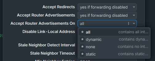

The dialog you mentioned does not allow me to select a specific interface:
In WinBox you can go to the Interfaces -> Interface Lists window, then on the right side, click on "Lists". There you can create a new list. Then back to the Interfaces -> Interface Lists table, you can add interfaces to that list.
Or with commands:
add name=ACCEPT_RA_LIST
add interface=mgmt list=ACCEPT_RA_LIST
Then set the list to the IPv6 settings:
/ipv6 settings
set accept-router-advertisements-on=ACCEPT_RA_LIST
