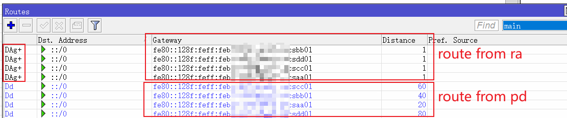

I've noticed that after updating to version 7.21.1, if IPv6 RA is enabled in the settings, it automatically creates a default route for the corresponding interface. This behavior didn't seem to exist in the older versions. How can I prevent it from automatically creating the default route? Or is it possible to specify the distance?

First, "route from PD" is a hack. DHCPv6 doesn't have default route information. The checkbox "Add Default Route" in the DHCPv6 Client setting is a MikroTik invention. You only need that if RA fails to give you the default gateway.
The correct way to get the default route for none P2P situations (not PPPoE client, for example) is to turn on "Accept Router Advertisements", which results in what you see as "route from RA" in your screenshot. From 7.21 you can now limit the interfaces where RA is accepted, by creating an interface list:

I have multiple WAN interfaces, and each interface receives RA routes. However, currently, there is no way to specify the distance for routes obtained via RA. This results in all received routes becoming ECMP routes. I want to specify a priority order, similar to how the routes obtained from the PD in the screenshot have different distances assigned.
If this isn't possible, is there a way to configure it to not install the routes (only receive the addresses), and obtain the routing information solely from the DHCPv6 client?

Thank you for your reply. As you pointed out, I am indeed obtaining RA over PPPoE. However, my inquiry is less about a strict requirement for the RA address itself (since, as you mentioned, I can alternatively assign addresses from the PD pool; our ISP here only provides prefixes, not specific IP addresses), but rather a technical discussion.
Specifically, in a scenario with multiple Ethernet interfaces, how can one obtain multiple RA addresses (rather than being limited to designating just one interface for address acquisition) while also being able to specify the distance?
