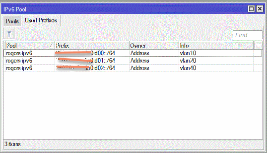

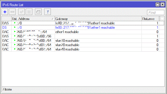

Yes it is possible, I am doing this with 3 vlans and it works perfectly. My ISP gives me a /56
Following is my ipv6 code that perhaps can help you get there.
/ipv6 address
add address=::/64 advertise=yes disabled=no eui-64=no from-pool=rogers-ipv6 \
    interface=vlan10 no-dad=no
    interface=vlan20 no-dad=no
    interface=vlan40 no-dad=no
/ipv6 dhcp-client
add add-default-route=yes comment="delgate ISP-assigned prefix" \
    default-route-distance=1 dhcp-options="" disabled=no interface=ether1 \
    pool-name=rogers-ipv6 pool-prefix-length=64 prefix-hint=::/56 request=\
    address,prefix use-peer-dns=yes
