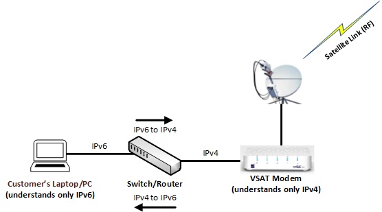

Anyone can suggest me best RB for attached diagram. Should the RB750GL work??
The Switch/Router placed in between should support IPv6-IPv4-IPv6 transition.
I don’t think routeros support nat64
