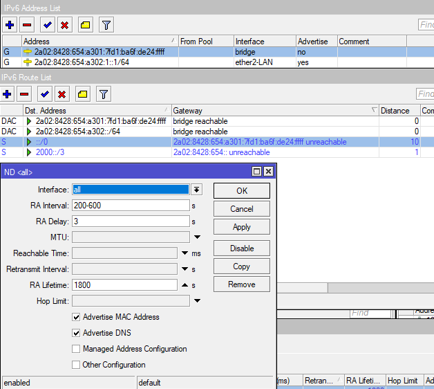

start from this config, remove other ipv6 address on /ipv6 address and the other manual ipv6 route on /ipv6 route:
/ipv6 route
add distance=10 gateway=>>>*** source ipv6 interface ***<<<
add distance=1 dst-address=2000::/3 gateway=2a02:8428:654::
/ipv6 address
add address=2a02:8428:654:a302:1::1 interface=ether2-LAN
add address=2a02:8428:654:a301:7fd1:ba6f::/56 advertise=no interface=>>>*** source ipv6 interface ***<<<
/ipv6 nd
set [ find default=yes ] advertise-dns=yes advertise-mac-address=yes interface=all managed-address-configuration=no other-configuration=no
my previous post has modified for typo, check again
it does not progress better :frowning:
use out inerface on gateway, not IPv6 ip on ::/0 route, check twice my modified post, please
on script >>>*** source ipv6 interface <<< must be like “ether1-WAN” (I haved use your ether2-LAN as example)
but I see you have also one bridge, for what?
if the ether2-LAN is part of the bridge, you must assign the ip to the bridge, not to singe ethernet
if the bridge are the “WAN”, you must use “bridge” as >>>

a progression
The bridge are ether2-LAN
ether1 are WAN

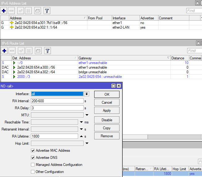

paste this on terminal:
/ipv6 route
remove [find where dynamic=no]
add distance=10 gateway=ether1
/ipv6 address
remove [find]
add address=2a02:8428:654:a302:1::1 interface=bridge
add address=2a02:8428:654:a301:7fd1:ba6f::/56 advertise=no interface=ether1
/ipv6 nd
I’m so sorry I couldn’t do it, I followed the procedure, but I have no result.
