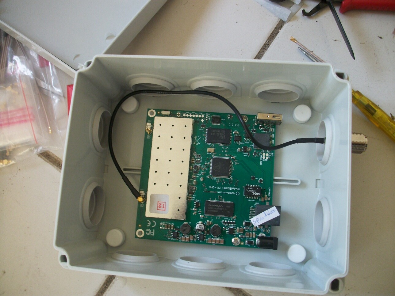

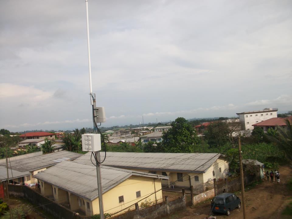

Can i please have installations pictures,
how you connect to your antennas?
the Chain you use ![]()
and the enclosure
This Are some picts
