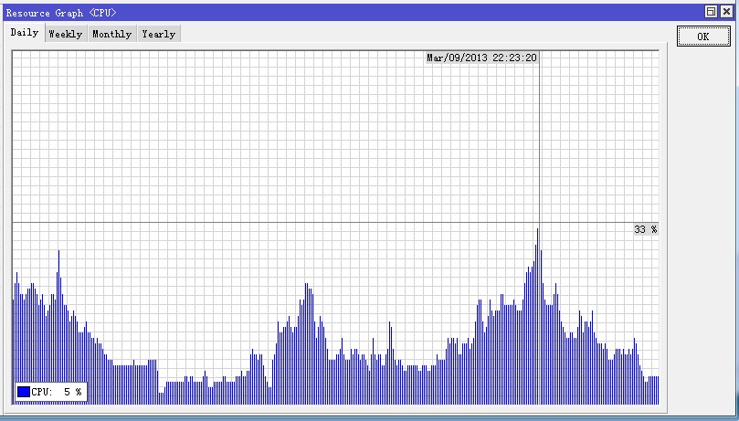

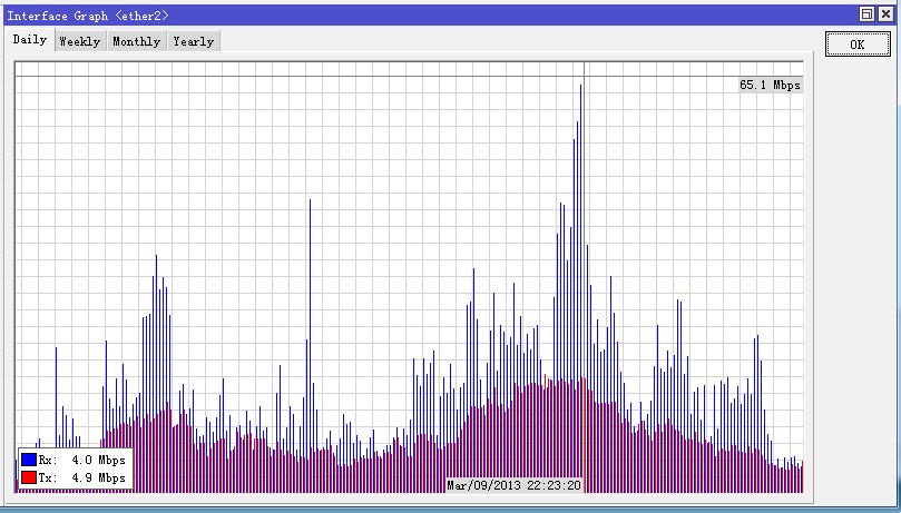

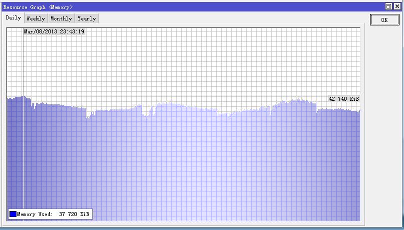

Hi Nelson,
I think CCR series is better than RB series in your case. Here is an example which with 5x20Mbps load balance, policy route, about 100 users, hotspot and qos. It’s using x86 version ROS with an Intel E2140 1.6GHz x2 and 512MB RAM.
