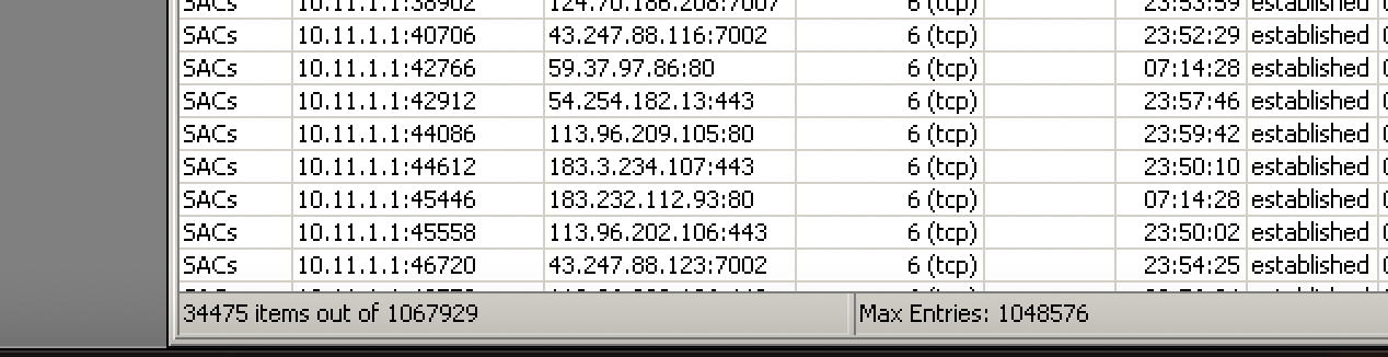

Current max entries is 1048576 while using is around 1057000. Is it full ?
Is there anyway to increase it ? I am using 6.45 on CCR1036.

the timeout are reset each time a packet travel on connection
some timeout for me are excessive
set timeout like what is suggested here, but set TCP estabilished timeout to 1h instead of 1 day:
https://blog.apnic.net/2021/06/24/how-to-edge-router-and-bng-optimization/

Not likely. Reboot associated to upgrade cleared connection tracking trable, but without shorthening some timeouts (the TCP established timeout in particular) the connection tracking table will fill up again in a few days.
