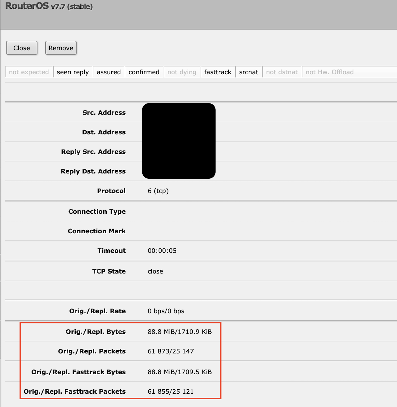

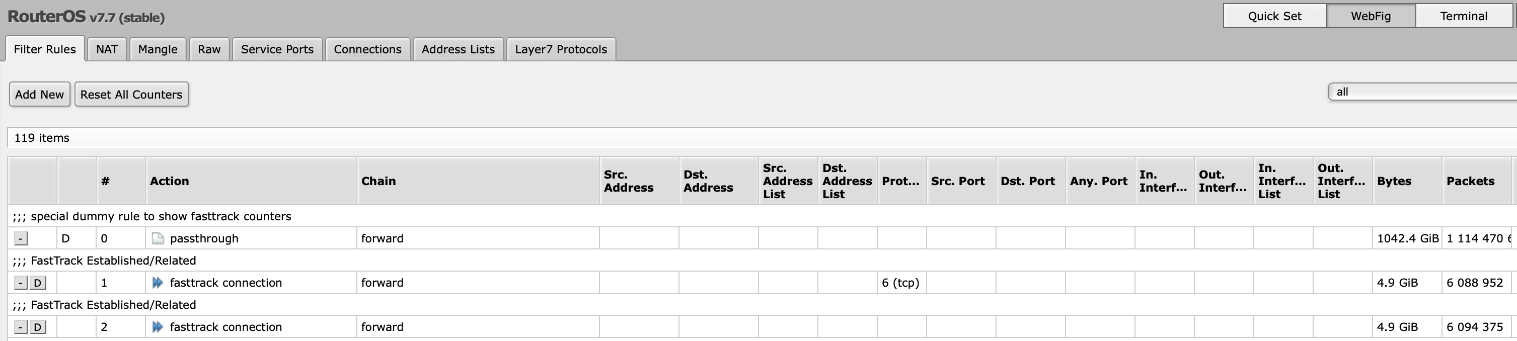

I have about 50Mbps of TCP flows running in background and I see the counters increasing for almost the same amount on both rules, while I would expect them matching only the first one:
If the first rules matches the traffic, it means that it’s related to an established/related TCP connection, so why does it go to the next rule? Is this due to the fact that the traffic can’t be HW offloaded because of insufficient resources and then it falls through the rule and matches the second one?

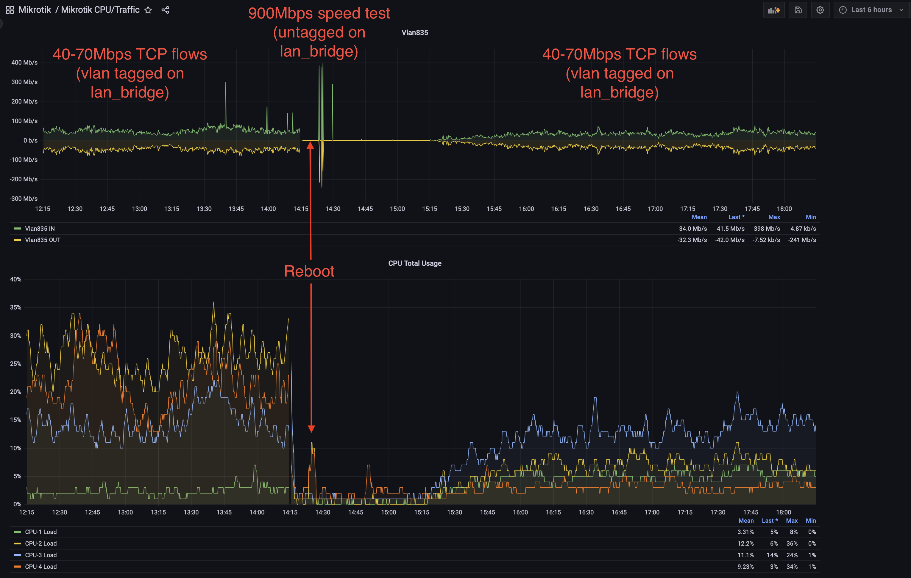

I’m trying to understand if my speedtest went from 930Mbps to about 400Mbps after upgrading from 6.x to 7.7 since it seems that when it transfers 200MB of data that data is accounted both on the fast track rule (I’ve tried by letting only the first fast track rule enabled) and on the accept rule, thus meaning that no data is being hw offloaded, or did I misunderstood how it should work? Could it be related to the upgrade to 7.7?
Ps: maybe it’s an issue of my provider limiting download but it happened the same days I’ve upgraded to 7.7.
PPS: I have vlan-filtering enabled on the lan bridge traversed by traffic but I’ve tried disabling that too and nothing changed.
Hi, I’ve cleaned up my config and I’ve found a port-mirroring set on switch1. I’ve disabled it and nothing changed. I’ve also removed unused bridges and
now I have only a single bridge. After a reboot of the device I went back to the usual 930Mbps of throughput :slight_smile: :

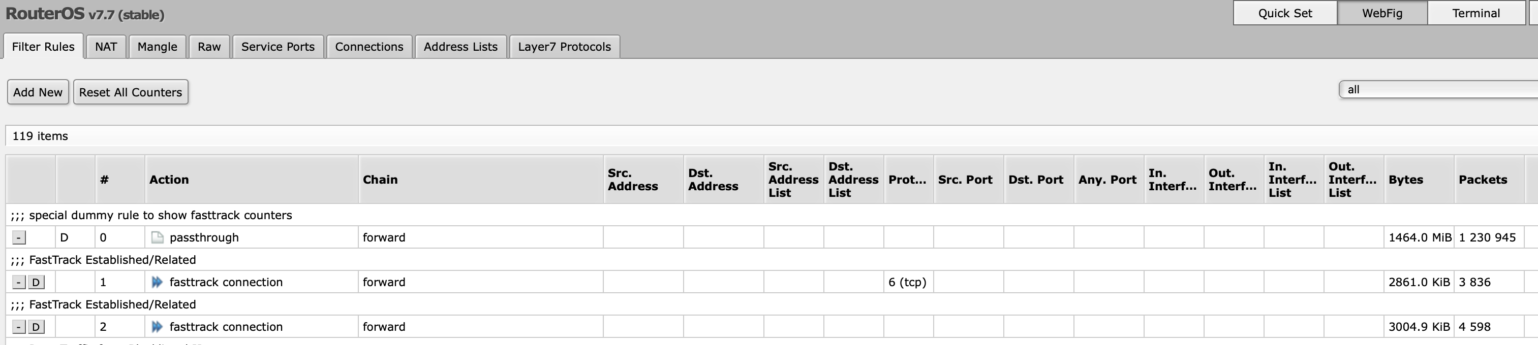

As you can see now the 1.4GB of traffic I’ve did with the speed tests has been counted only by the first dummy rule and the two fast-track rules now matches only very few packets (because I suppose the other ones get HW offloaded). BTW, both rules match almost the same packets, maybe it is due to the fact that my HAP AC2 does not support HW offloading given the following output?

I suppose that now the second one is effectively offloading the traffic even without HW acceleration and this is why it matched 3MB of the 1.4GB transferred via speedtest (the same for the standard ACCEPT rule for Established/Related traffic that follows the two fast-track rules). I’ve checked the active connections and fast tracking seems to work (this is one of the 4 connections started by Speedtest cli command):

BTW, now the CPU utilization went back to lower levels and throughput had a 3x boost to the usual 930Mbps over PPPOE (graphs show 3-400Mbps but it is due to the fact that speedtest traffic lasts too few seconds), quite amazing for such a small piece of hardware.
