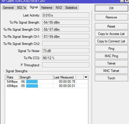

Is it possible no one can help me for my problem i Tried everything but its same ccq is not good but signal is good
see this pic

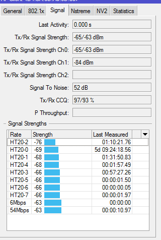

see this pic
I hope it will help you… signal is good ![]()

The rx CCQ being so low means that much of the information your radio is receiving is not usable. I would suspect an antenna issue or some reflection issues. Do you have something large near by that the signal could be reflecting off of? I don’t think its interference because your signal to noise level is good.

It also seems odd that your only showing two modulations do you have most of the others disabled? I would go back to the default modulations if you have them customized.
