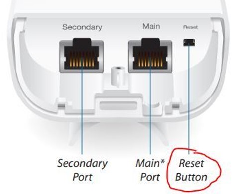

recently i found another brand put the reset button on their PoE. perhaps MikroTik team can do observe and put this on the PoE products.
So, in your opinion, that reset button is used to reset the powered peripheral...
not the device itself...

I don't think that photo in this post is a PoE injector. That looks like a NanoStation M2 radio.
However those did have remote factory reset via a reset button on the power injector.
See this and this more more technical details (these were from non-official reverse engineered posts).

Exactly, that is the point. i do not want the expose the exact brand that already implement it.
that reset button is not for power cycle, but to do factory reset of the hardware / radio connected to it. Perhaps MikroTik can do this too.

And the image has nothing to do with it...
Also because it's obvious it wasn't a PoE...
