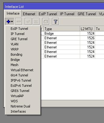

I would like to make L2TP tunnel using RB750 as L2TP client. Problem is that I can not make tunnel form RB750 because there are no L2TP options. I have latest firmware and latest RouterOS image with Level 4 license. Is it OK that RB750 lacks L2TP options?

From winbox go to interfaces and press the blue cross + to add new interface
Here you can find the L2TP client
Yeah, that’s my problema - there are no L2TP option.
Which packages of RouterOS you have installed?
Install ppp package.
Thank You, jarda! I installed all packages but ppp was somehow disabled.
