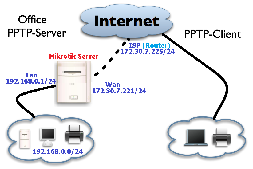

Is it possible to setup MK O.S-3.2 Server as VPN server
Like this picture
I mean Clients have to connect to the MK server from internet and browse the
Local network.
If so please write some instructions.

There is a manual for a reason.
The only obvious problem with your diagram is that you need a public IP address on your Mikrotik.
Yes I have a public IP address on my Mikrotik
can you send my link for example or steps for this

winbox → PPP → Interface tab → PPTP server button → enable it. (check all athentication methods, later you can disable ones that you don’t need)
then go to secrets tab → create new one (watch about local and remote address ex. local=local address of port on mikrotik that goes to LAN, remote - any address from LAN segment)
try to log in from remote location
if fail try to change interfaces → interface → ARP value to enabled or to proxy-arp I can’t remember what is right.
First of all thanks to Mr. cvelee
You are such a nice guy; your instruction is very simple and effective
When I try to connect to Mk it verifies the user and pass word ok then
“Registering your computer on the network” then give an error 720
One thing My Wan IP on MK. Is 172.30.7.208
My Local IP on MK. is 172.30.4.1
Which of them is the remote address?
And which is the local address
Did I miss something?
