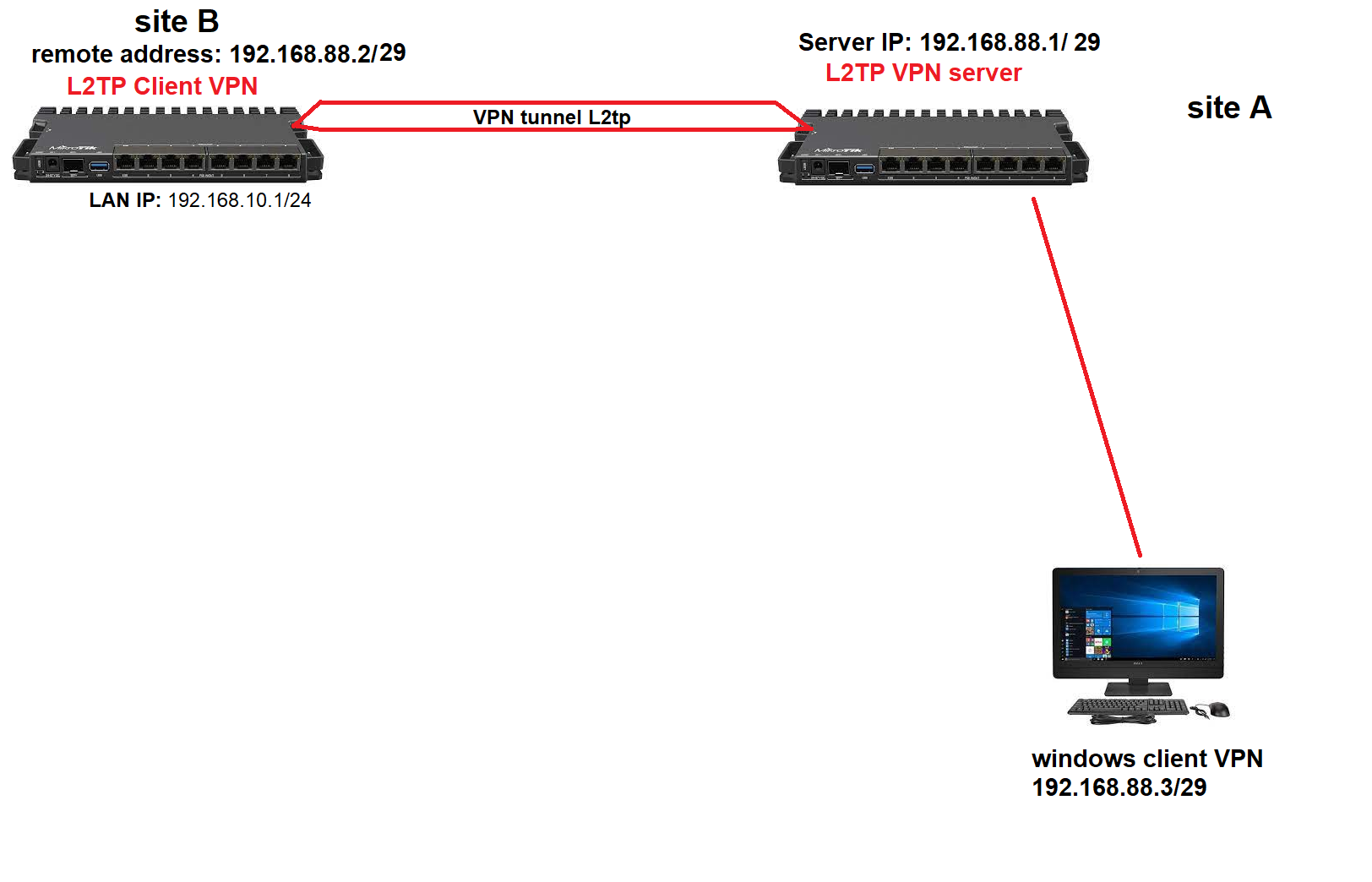

Dear all,
I have 2 site
Site A will be the VPN server
I want Site B to be connected with Site A through a VPN. and I will dial Windows client VPN on my desktop and will be able to access site B Lan resource.
How I can deploy this..?
Please suggest any idea for that

Your picture is incorrect, PPP-based connections are assigned /32 addresses so the L2TP client and server will be 192.168.88.2/32 and 192.168.88.1/32.
Add a static route for 192.168.10.0/24 to the PPP secret for site B on site A, the L2TP server - this allows site A to forward traffic for that subnet via the VPN tunnel.
Add a static route for 192.168.88.0/29 on site B using the l2tp-client interface as the gateway - this allows site B to forward traffic for that range of addresses via the VPN tunnel.
If using not using the VPN as the default gateway on the PC add a static route for 192.168.10.0/24 via the VPN connection, you can use powershell to make this permanent rather than adding it each time a VPN connection is established.
Change any firewall rules to permit forwarding via the interfaces involved.

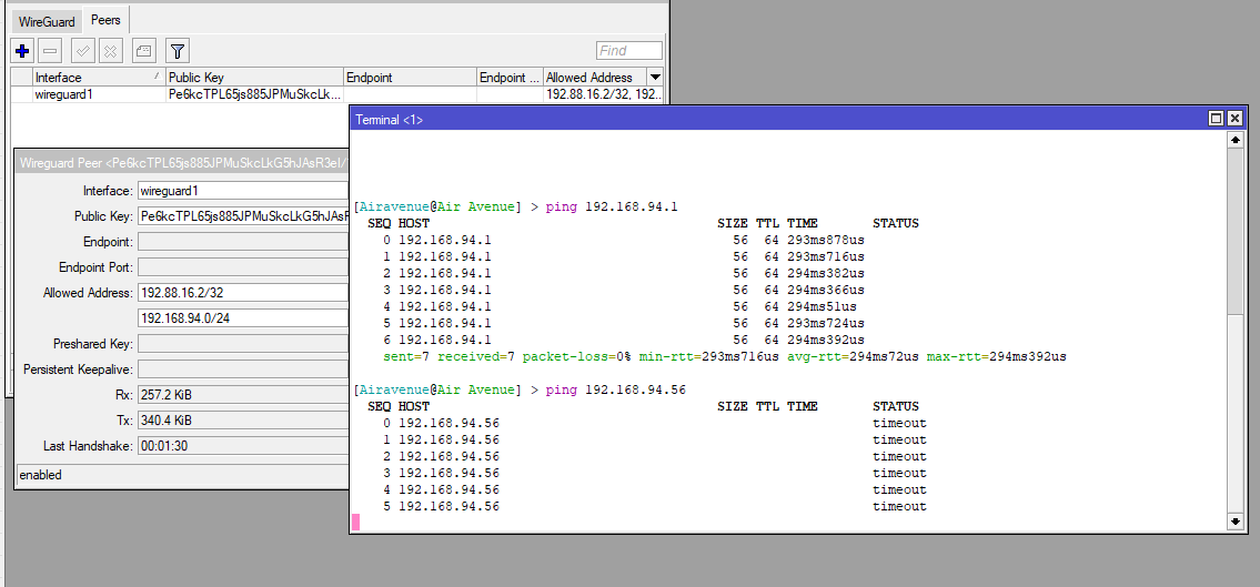

Dear Sir,
I have configured this.
I have followed all procedures.
static routing
also power shall in windows

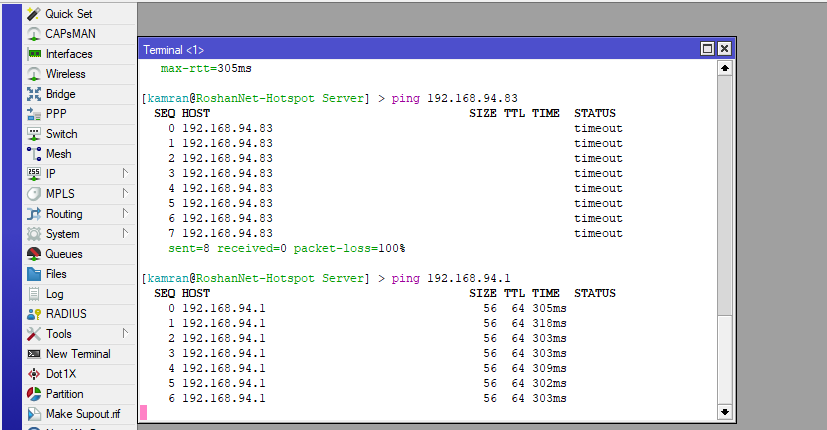

But only able to ping the gateway. 192.168.94.1
not able to ping other Ubiquiti PowrBeam M5 AC IP e.g(192.168.94.83 not able to ping)

Only reachable Gateway: 192.168.94.1
My Ubiquiti APs like Airfiber is not reachable at 192.168.94.56
Not able to ping/Access my LAN network on Wireguard site to site Tunnel
