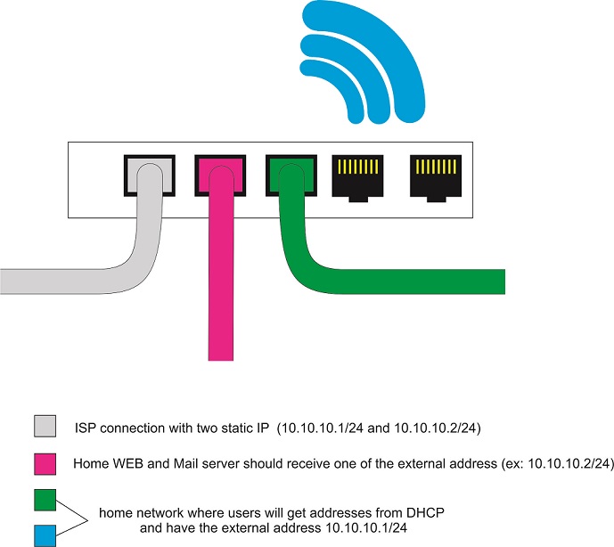

Not so long ago, I purchased RB951G-2CHnD. And decided to equip a home network.
A vailable from a cable provider with two static addresses, home server and home network users. need to make sure that the server were seen at one address, and users on the other … :confused:
bridge port1 and port2 (grey and pink)
bridge port3 and wifi (green and blue)
set .2 ip on the web&mail server.
set .1 ip on the first bridge
set another ip on the second bridge (different ip class x.x.x.1)
create dhcp server on the second bridge and start giving addresses from x.x.x. class
enable nat masquerading
test and see if it works
add some firewall rules if they are necessary.
Thanks for the tip, made differently.
in the standard configuration untied 5 port, and then set up the bridge and slapped back ports 1 and 5. After all the values ​​mentioned where ether1 replaced the bridge
then a bit of magic, all my settings I easily restored :sunglasses:
thank you very much for having that sent in the right direction
