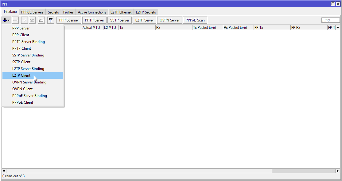

  1. I input a working vpn server address (from www.vpngate.net) under PPP → Interface → ToVPN (this is my interface name) → Dial Out (in order to activate the L2TP VPN). Note please that I have also added use-ipsec=yes → use-ipsec=required as per last comment by @kalamaja.

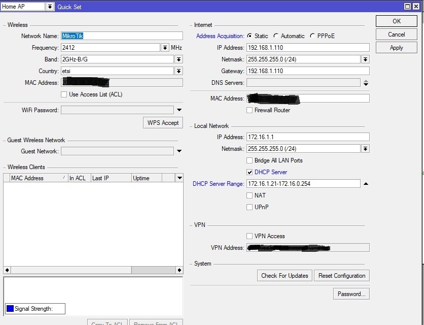

  1. I opened Quick Set → Home AP → Internet → Automatic → IP Address (192.168.1.110), Netmask (255.255.255.0 (/24)) and Gateway (192.168.1.1) were already populated automatically.
  2. Under Local Network → I manually set IP Address to (172.16.1.1) and DHCP Server Range to (172.16.1.21-172.16.0.254), Netmask was already populated as: 255.255.255.0 (/24)
    Question: Why does ‘Address Acquisition’ under Internet in Home AP changes from Automatic to Static as soon as I click Apply and OK to save the above changes? Is this normal?

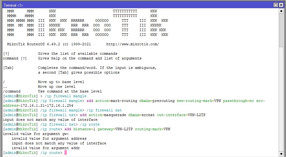

  3. I then applied your Rule 1 in a new terminal; all okay.
    [admin@MikroTik] /ip firewall mangle> add action=mark-routing chain=prerouting new-routing-mark=VPN passthrough=no src-address=172.16.1.21-172.16.1.254
  4. Then applied Rule 2: (gave error)
    [admin@MikroTik] /ip firewall nat> add action=masquerade chain=srcnat out-interface=VPN-L2TP
    input does not match any value of interface
  5. And Rule 3: (also gave error)
So, I couldn’t proceed beyond Rule 1. Have I missed something so far?

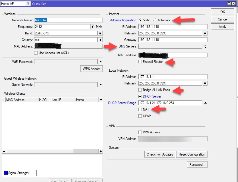

The idea behind the reset config was for you to have a default IP Range and settings and you did replace it with your old config again.
Anyway
There are a few things.
No, you did not change your L2TP Client interface name. Therefore you got an error in 2-3 rule 3 is depends on the gateway name. so it did not register too. even if you did rename your interface then there is another variable in the picture for the routing rule.
You did not enable your firewall again.
I think it’s time to try remote config.
I think this is a quick set problem.
The gateway in your static IP is wrong too it should be 192.168.1.1 not 110
