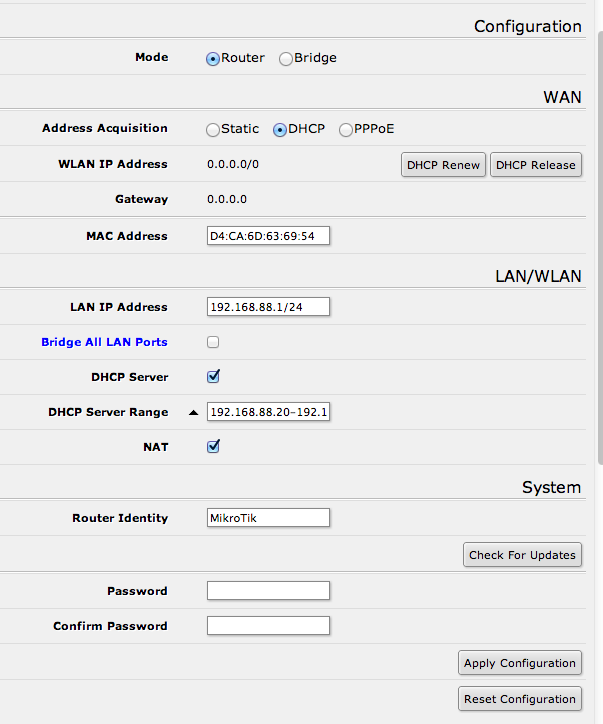

Actually mine works now, but it doesn’t show any IP in this view
That display isn’t showing you an IP Address probably because Address Acquisition is set to DHCP.
Try setting it to PPPoE and see if it changes / shows you your dialler settings / status.
