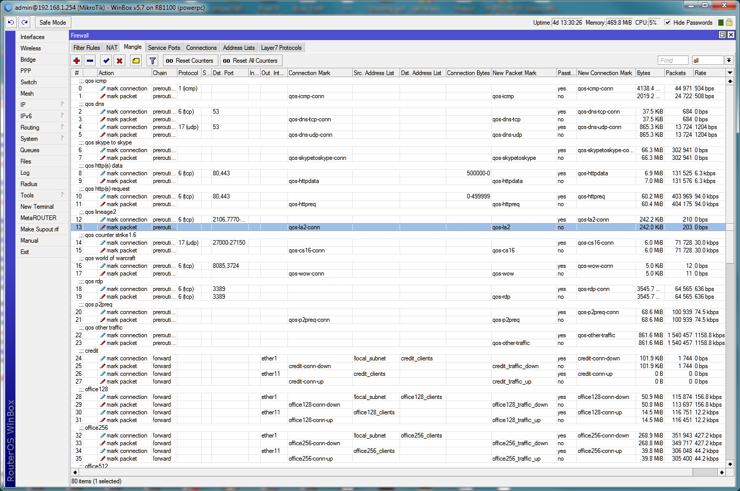

I have carefully create mangle rules, queues - no luck!

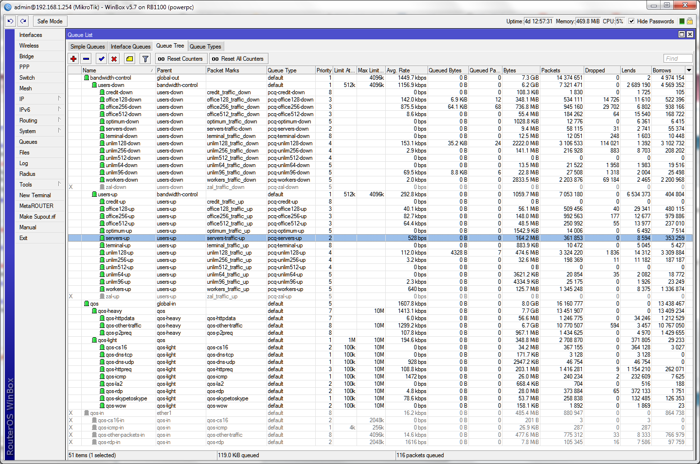

I have put light traffic to a queue with high priority and with limit-at equal to a full speed of my internet (on screenshots below there is limit-at decreased to 1/4), and put heavy traffic to a queue with lowest priority and with limit-at equal to 0.

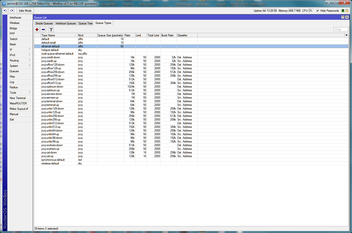

Here is my mangles and queues screenshots.

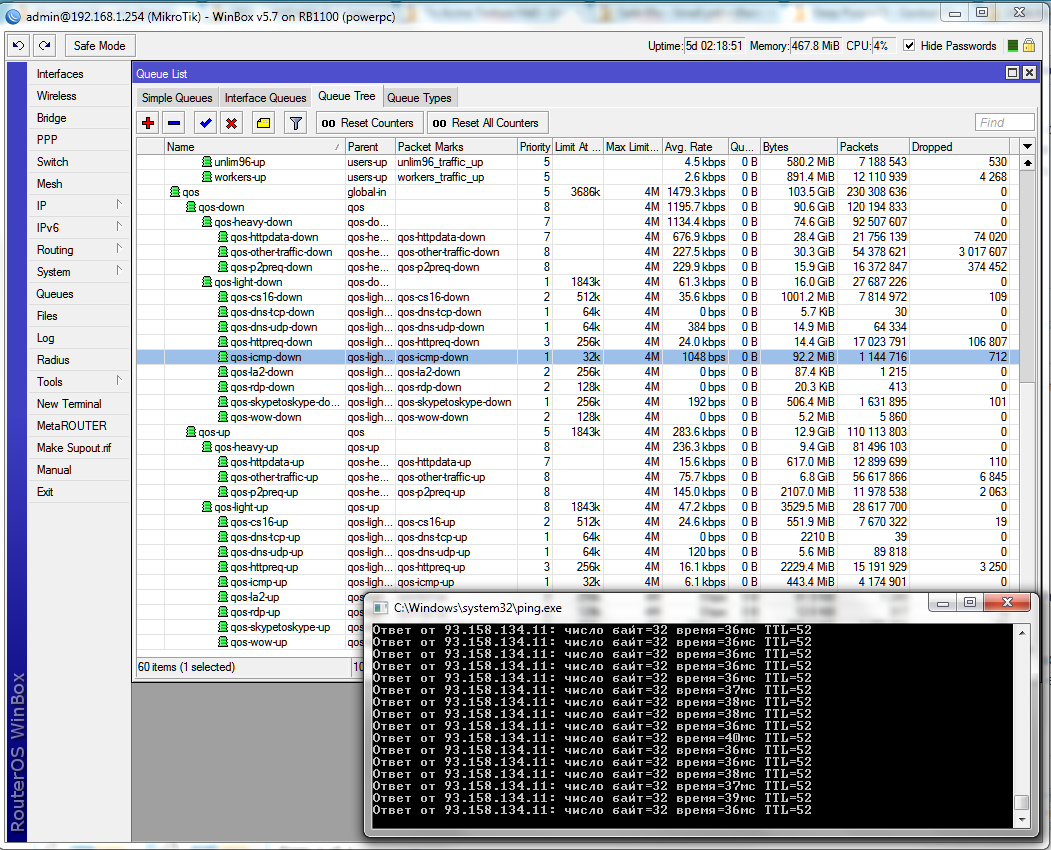

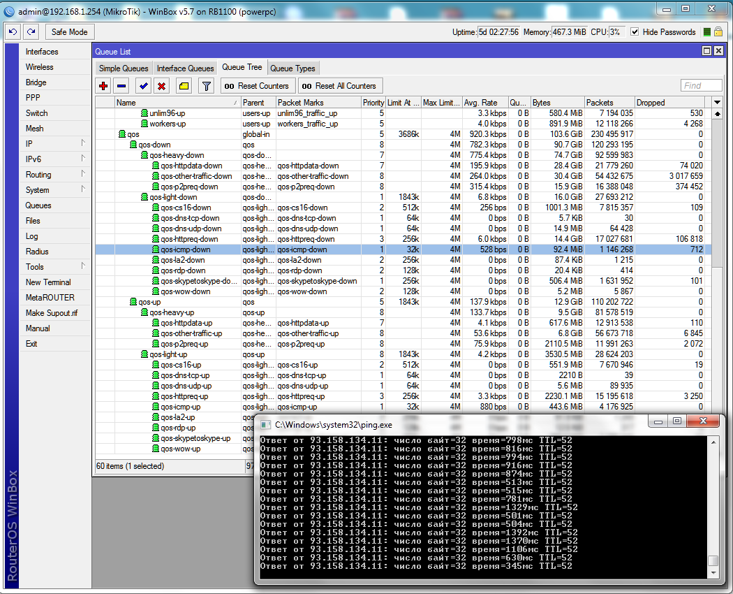

Here is what I meant about latencies:
If user downloading a file and trying to play online games, he will see long latencies (400-2000).
I simply want to make ping, online games, dns and skype traffic pass first, at least for the total traffic, not per-user.
Here’s screenshots:
