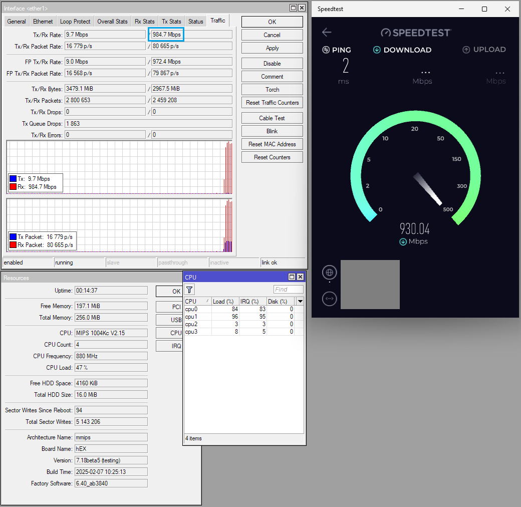

PPPoE on RouterOS uses single core (per PPPoE connection) but for your use case (PPPoE to ISP as WAN line) the performance overhead is negligible. The single thread processing only applies to the encapsulation/decapsulation of the PPPoE header, the rest like routing, NAT, firewall, etc,… are still distributed to multiple cores if you have multiple connections (connections inside the PPPoE tunnel).
Below are speed tests done over a single PPPoE WAN line with the old hEX RB750Gr3, fasttrack for both IPv4 (1st screenshot) and IPv6 (2nd screenshot) are in used. You can see that 985Mbps can be pulled over ether1 (the ethernet interface underneath pppoe-out1) and that two cores of the CPU are fully loaded, and it’s not limited to a single core. The hEX has only two real CPU cores. Four CPUs are listed because it supports hyperthreading.
Which means you’ll need something barely (5%) faster than the RB750Gr3 to saturate a Gbps PPPoE WAN line if you can use fasttrack (with is now available for IPv6 too).
