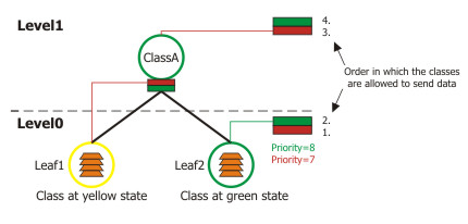

priority > - order in which classes are served > at the same level
and lower:
Priorities
When there is a possibility to send out a packet, HTB queries all its self slots in order of priority, starting with highest priority on the lowest level, till lowest priority on highest level. Each leaf class (packets are stored and enqueued only within qdiscs attached to each leaf class) is ultimately connected to a certain self slot, either directly or through a chain of parent classes:
As you can see from the picture, leaf-classes that are in the green state will always have a higher effective priority than those that are yellow (and, thus, borrowing their rate from parent classes), because their priority is at a lower level (level 0). In this picture, > Leaf1 > will be served only after > Leaf2> , although it has a higher priority (priority 7) than > Leaf1 > (priority > :sunglasses:> .
In case of equal priorities and equal states, HTB serves these classes, using round robin algorithm.
