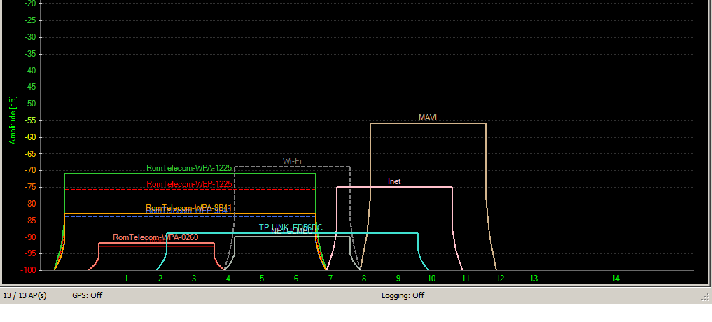

Now the issue is playing the same movie via wifi :
laptop/phone (wifi connection) — DD-WRT (router) (wifi 802.11n with HT20 or HT40) — TV (wired)
The movie is played with interruptions, plays fine for a minute or so, then is played with interruptions every 3 seconds (like is buffering or something or I don’t know) .
I was wondering what the issue is:
  • the crowd APs from my area (please see the attached pic) - AP is on channel 10
  • the router ? (if so, I was wondering if a Routerboard WiFi router will do better ?)
Any idea how do debug this ?
offtopic: what’s the program that makes that nice graph?
Inssider http://www.metageek.net/products/inssider/
