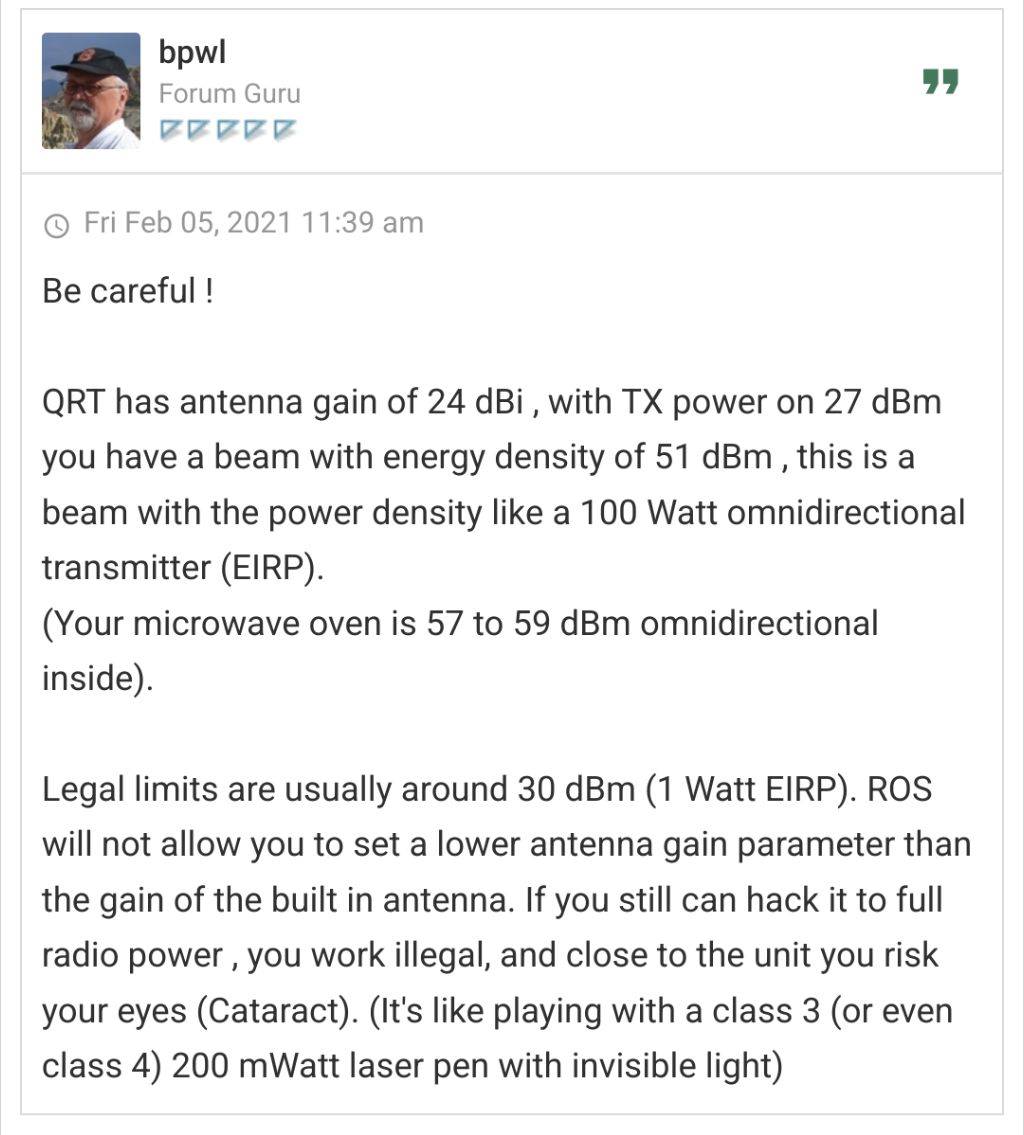

While I know my setting are correct and within legal limits how do you protect yourself when working around other antennas you don’t have access to? I always remember this post from bpwl where he states that at a certain power output you can go blind. Where is the limit after which can the Tx power harm a person working around the antenna?
Well some of this is old info. Safe distance for 20dBm was documented as about 0.15 meter in EU . It would double for a 6dBm higher power .

So that -1 dBm is far from OFF, it is around 0.8 mW
