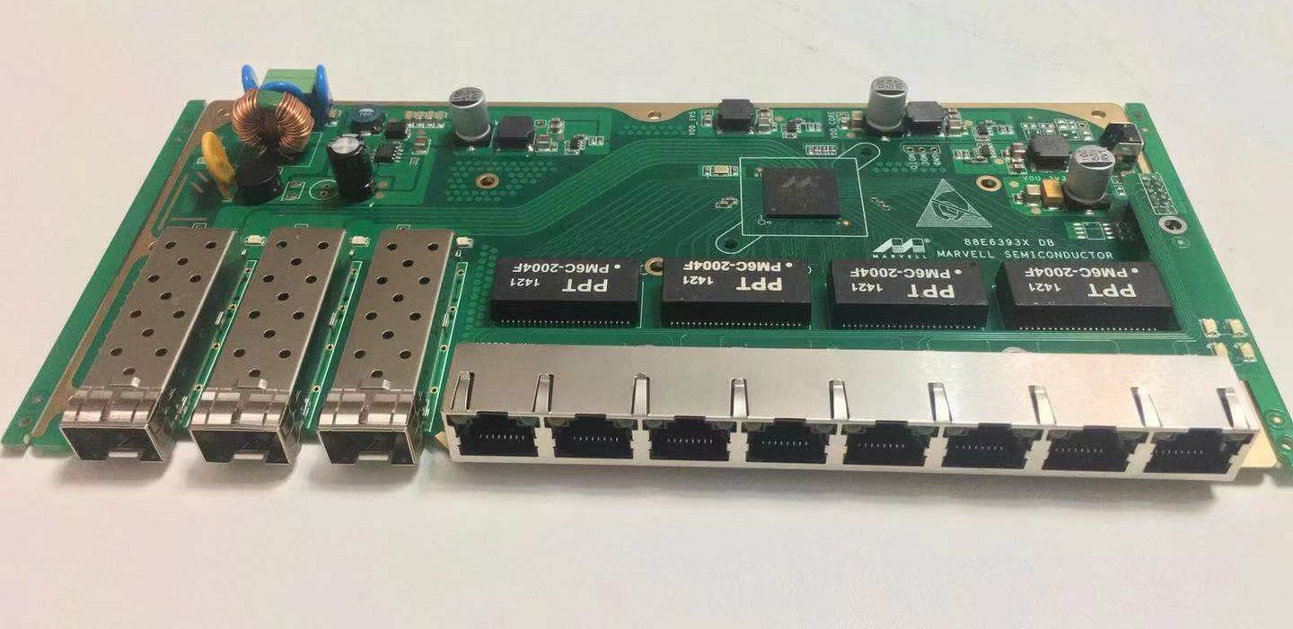

This is a Marvell reference design for the 88E6393X switch chip used in RB5009:
A RB5010UG+2S+IN would not have the leftmost 10G SFP+ cage and use the port towards the CPU. The rest is not much wider than a RB5009.
As I already wrote: if MT wants to keep form factor, then it can’t be any wider than RB5009. If you check RB5009 (or published photographs if you don’t have access to one), then you’ll notice weird sides … partially they’re weird to make cooling more effective and partially they enable all the mounting possibilities. But they do make internal space quite a bit narrower.
