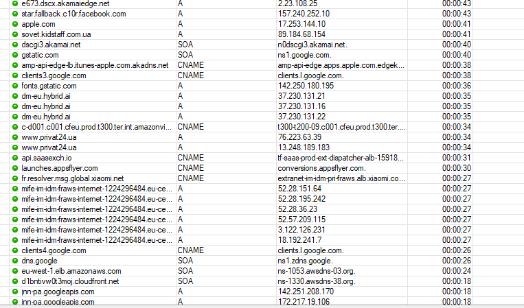

Same situation. DNS caching stores EVERYTHING. What is the reason to store entries that have 30 seconds expiry time? It just uses CPU without profit for end users…
It’s just following the provided TTL by a returned record, which be typically low for CDN for to maintain freshness.
Whether caching these short duration records is technically “overall efficient” (CPU, memory, etc.) — I don’t know but maybe. But RouterOS is “correctly” respecting the TTL provided.
While there is the “cache-max-ttl” option, but that limits the maximum TTL for really long TTLs. But there is NOT a reciprocal for the minimum TTL to skip caching below, so that’s not an option.
But you can always use public/ISP resolver from clients directly & avoid Mikrotik DNS caching entirely.
