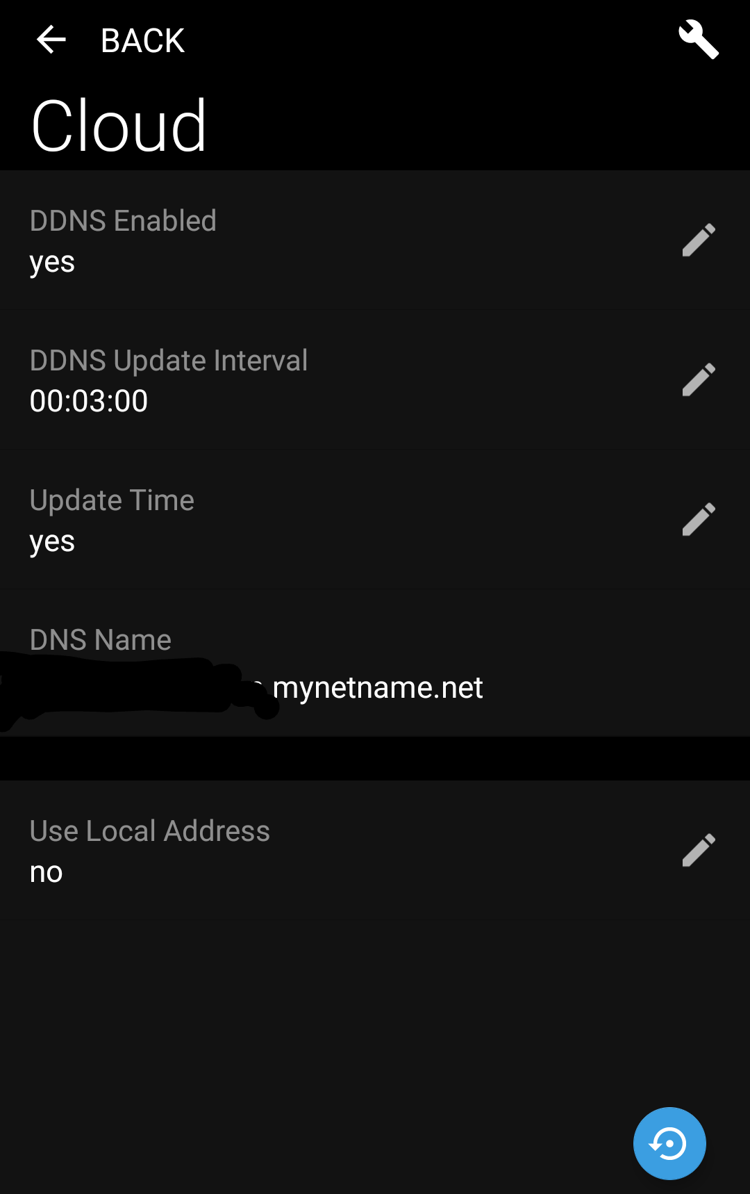

I also have the same issue since few hours. I have 6.48.2 installed on my hex.
No public ip address is being shown in ip cloud. Screenshot is attached.
