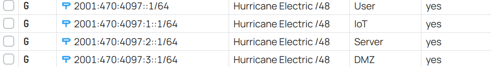

I wanted to learn a little more about IPv6 subnets so I started using HE tunnel broker and they gave me a /48 as I wanted to mess around with subnetting with IPv6. As far as I am aware from reading in this forum that you aren’t really allowed to choose the subnet and when you assign the address to the interface it’ll automatically select one for you for each interface. I’ve come into things like this where it’ll choose a number for the subnet and increment it 1-2 times before actually using it.
So I end up with something that looks like this
Any ideas on what might be going on here in regards to why the subnets aren’t sequential and appear to be skipping? Thanks.
Prefixes are handed out by pool sequentially. And ROS somehow remembers their assignment … which is good because generally same prefixes are reassigned to same interface (e.g. after reboot). So it seems that while you were playing (or should we say: learning), some prefixes were assigned to interfaces which are no longer present on router? Well, ROS did remember about that. Most probably those unused prefixed would get recycled after all prefixes are handed out (for the first time). Which, with /48 prefix, means after you use up all 4096 /64 prefixes. At least that’s my experience.

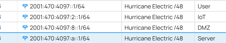

Thanks for the reply, I haven’t touched the addresses since the photo as I became busy and just today started fiddling with it and noticed the addresses automatically became sequential. I feel this is bad as my prefix is static but if Mikrotik is dynamically changing my subnet this would cause problems with DNS, etc. Do you know why this might happen? After a power outage or automatically overtime?
Currently, whenever you make a tiny change to the configuration of the (underlying) bridges or the VLAN interfaces, those affected interfaces (if you change a bridge, all attached VLAN interfaces are affected too) will all drop their currently assigned prefixes and the router pick new prefixes for them from the pool. That’s the reason why you saw those gaps in your previous screenshot. You can open the property of a bridge and toggle DHCP Snooping for instance, to see it happens. Or one VLAN interface and change ARP mode (although unrelated to IPv6).
Ahh that’s unfortunate, hopefully one day Mikrotik will give us the ability to manually configure subnets or at the very least allow the option for a automatically assigned static subnet.
