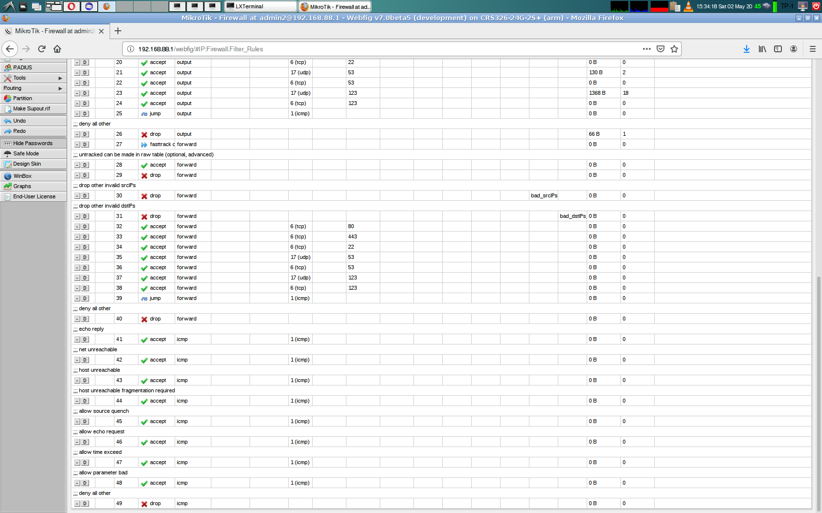

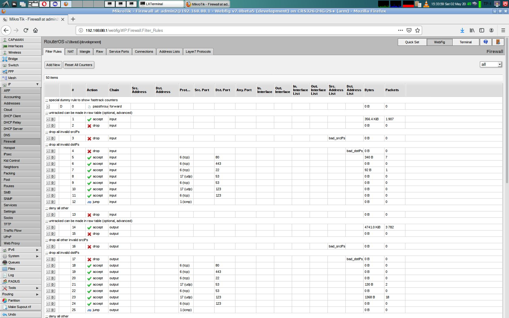

Now, I can tell you that most of the traffic is accepted in the output chain and to a fraction in the input chain, but there is nothing in the forward chain.
Hello! What about the forward chain? Cf. the documentation above: that’s exactly the discrepancy between documentation and reality I mean!.. :slight_smile:
Another mystery is: there is more data and packets accepted in the output chain than in input, and as already said: nothing in the forward.
But this can’t be true as there is no service here that sends that much data out: the input chain has to be bigger than the output, but which is actually only a fraction of the output chain.
Here are screenshots to show the counters that verify/confirm what I just said:
When fast-track is enabled, then counters don’t account for majority of traffic in forward chain … that’s how effective is shortcut called fast-track.
but take a look at the comment for the implicit rule 0. It says “special dummy rule to show fasttrack counters”
