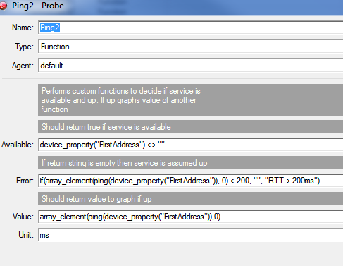

Yes create your own ping out of the ping command. The dude will give you false positives and re-pinging things will improve the RTT. RTT in the dude has neat features…
if(array_element(ping(device_property(“FirstAddress”)), 0) < 200, “”, “RTT > 200ms”)

can’t get this function running on my dude 4.0beta3
rewrite everything, set
if(array_element(ping(device_property(“FirstAddress”)), 0) < 2, “”, “RTT > 200ms”)
and with 15ms ping to the device - i didn’t get any info about ping response. why ?
