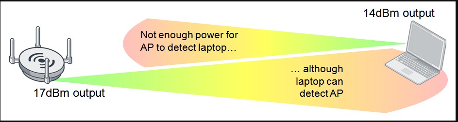

In most cases the transmit power of the client is the limiting factor, not the transmit power of the AP.
Mostly AP’s transmit near the max allowed power (20 dBm/30 dBm), however laptops, tablets and smartphones have a lower (14 dBm) to much lower (10 dBm) transmit power.
The (real physical) antenna gain plays an important role in amplifying the received signal. The transmitted signal (power + antenna gain) will be limited by the country regulation (EU = 20dBm), based upon the antenna gain value entered. (FCC even allows up to 30 dBm, the client device remains the weakest link)
